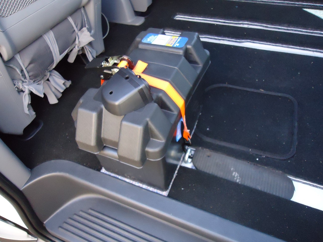

I have an RV/Marine 95 Amp sealed battery given to me by a friend (a member of this forum) and I would like to set it up in my vehicle as an auxiliary battery for running my portable 31 litre fridge/freezer when not travelling (eg; free camp etc).
Also wired up so it charges either off the main cranking battery alternator when driving or adding a Ctech charger to the system.
The portable fridge/freezer is the only item it would need to run. I have been looking at some different items including Dual Battery Kits but am confused as to what to get. I would not be installing this myself. The portable/fridge freezer would be in the rear of the vehicle.
The fridge has it's own transformer and socket/lead for charging direct on 240V when available.
I have attached a couple of pic's of some of the items I have been looking at in Supercheap Auto's. Could someone clarify for me what I will actually need especially for a 95Amp battery to do this work please.

02:04 PM Mar 16, 2014

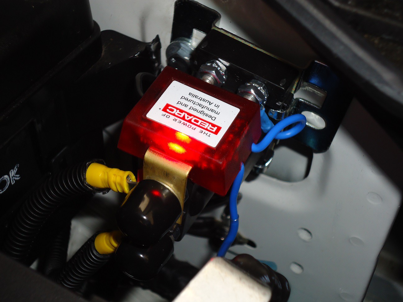

Thanks Happy Jack, I ended up having this Redarc system installed with a 95amp battery.
I only need mine for a 30l fridge/freezer and a small personal fan, but the auto electrician told me that for my needs and battery I wouldn't need a CTech, I did ask about it.

03_troopy said
06:55 PM Mar 17, 2014
Good to see the auto sparky used an existing threaded hole to mount the isolator instead of bashing in a couple of tech screws like a lot do these days. We install heaps of these, but in the 24V version, in Mine Service Trucks and have never had a complaint yet.
Vic41 said
11:51 PM Mar 17, 2014
Thanks for the feedback troopy, it was fitted by an auto electronics mob called Deering Autronics in Balcatta WA, they have a few stores in WA. As for me, I know zip about techo stuff, however decided to use this company due to being happy with their work in the past.
They also give either RAC or Seniors Discount on labour, and are RAC recommended.
http://www.redarc.com.au/products/product/smart-start-sbi_12v_100a/
cheers
blaze
Thanks blaze, I don't want to embarrass a GN members here unless he gives me the green light, but he kindly gave me 95 amp deep cycle battery and offered to install a dual battery system for me, but he is up to his armpits with work and his own projects so I declined as I didn't want to impose on his time, although he would have willingly done it.
I thank you too for your kind offer (eye and all) I just hope your recovery goes well.
Thanks for the heads up on the Redarc too, funny in the link they look so big, but when they are actually installed they are tiny in comparison, a bit like the Macca's ads, LOL !
