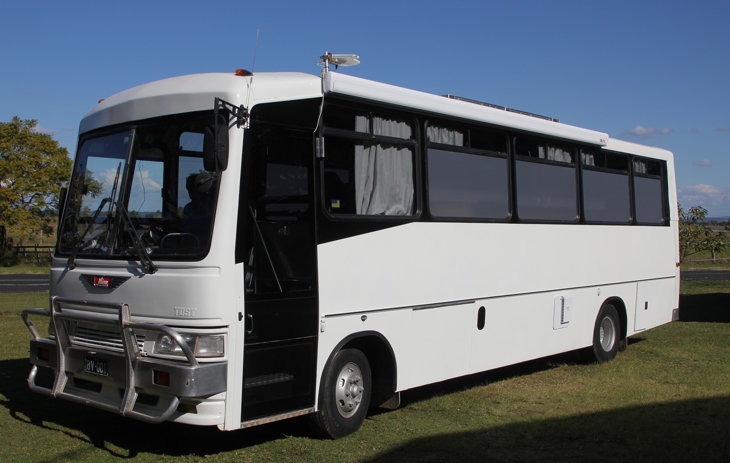

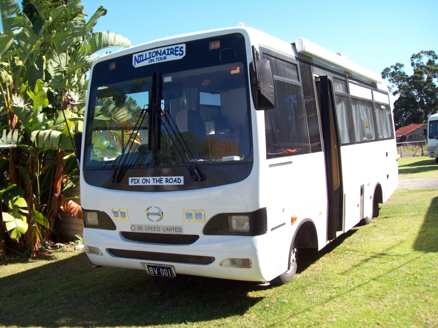

Gee Pete,
The last bus I did was a 2000 7mtr Hino, we picked it up in May down in SA drove it home via Broken Hill and registered it fully finished mid July and I an 75..
It is currently for sale as we have gone back to our old 1993 9mtr mid engined FD Hino..
This is the one for sale and the one we are now keeping..
