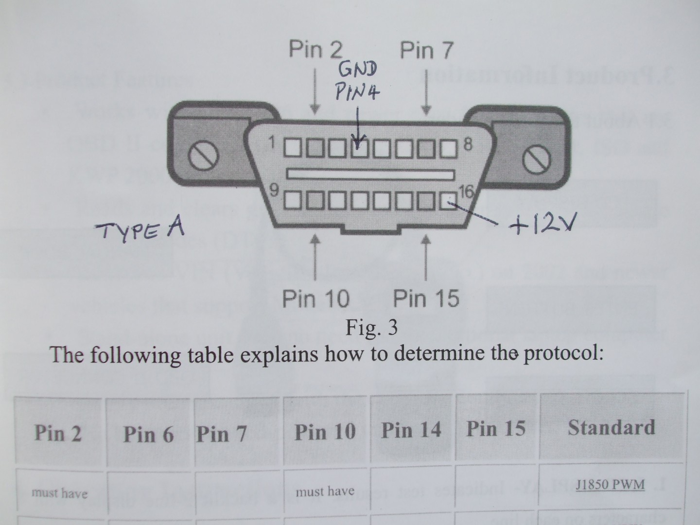

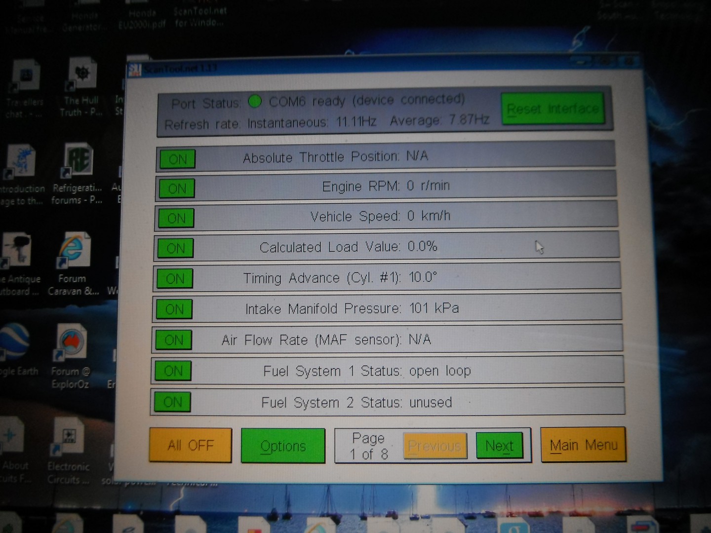

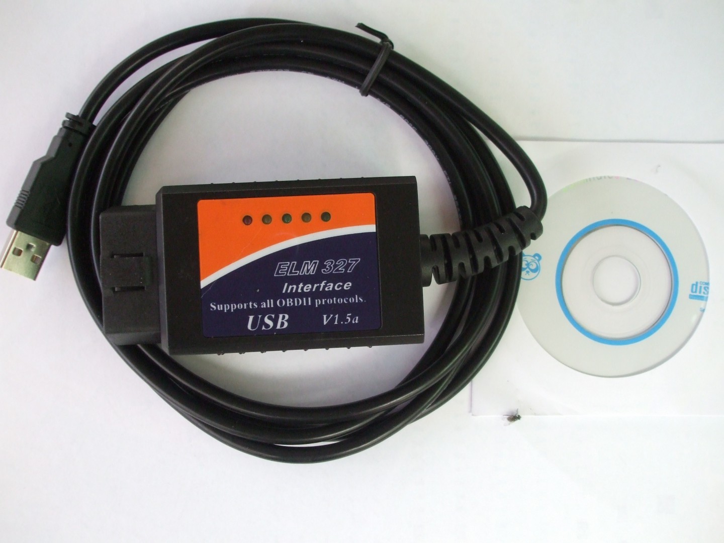

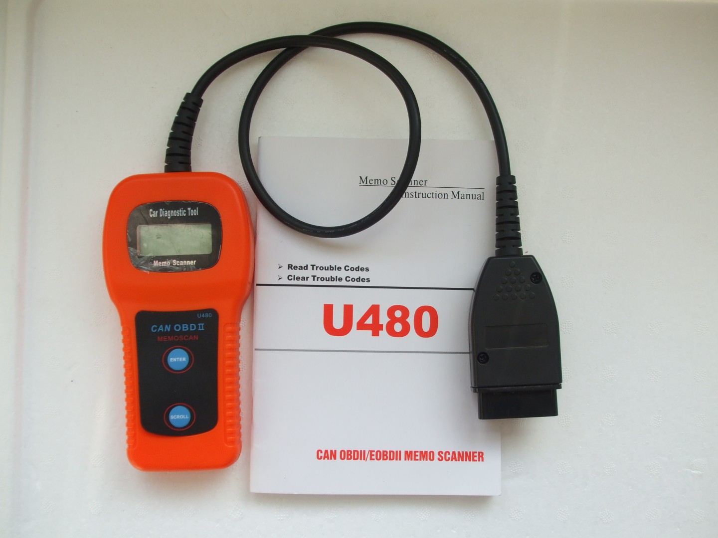

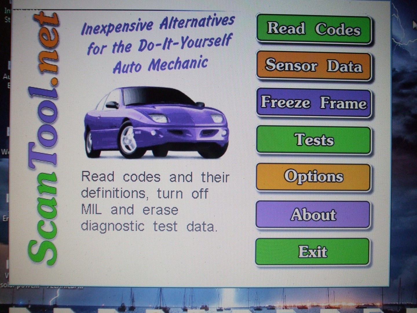

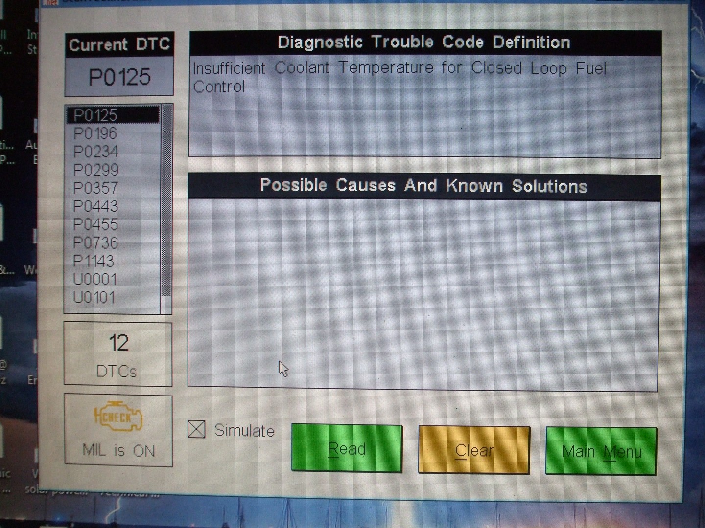

07:12 PM Dec 9, 2013
Correct term is OBDII .... On Board Diagnostics Version 2
This gives a full description of the what it is and the history.

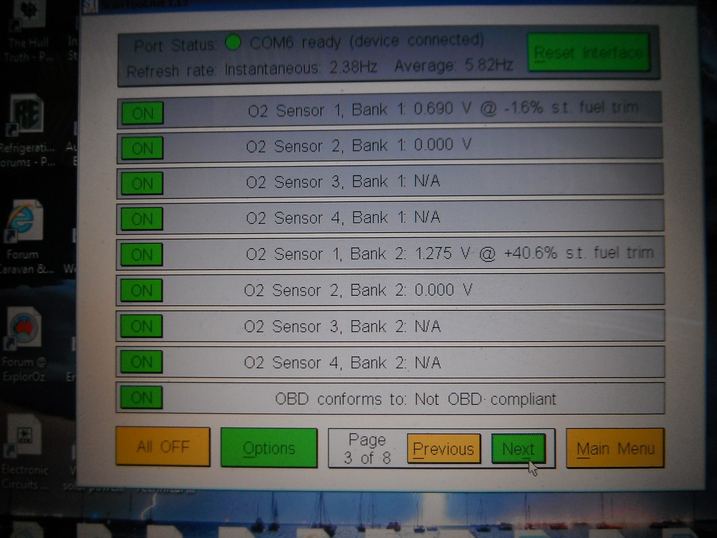

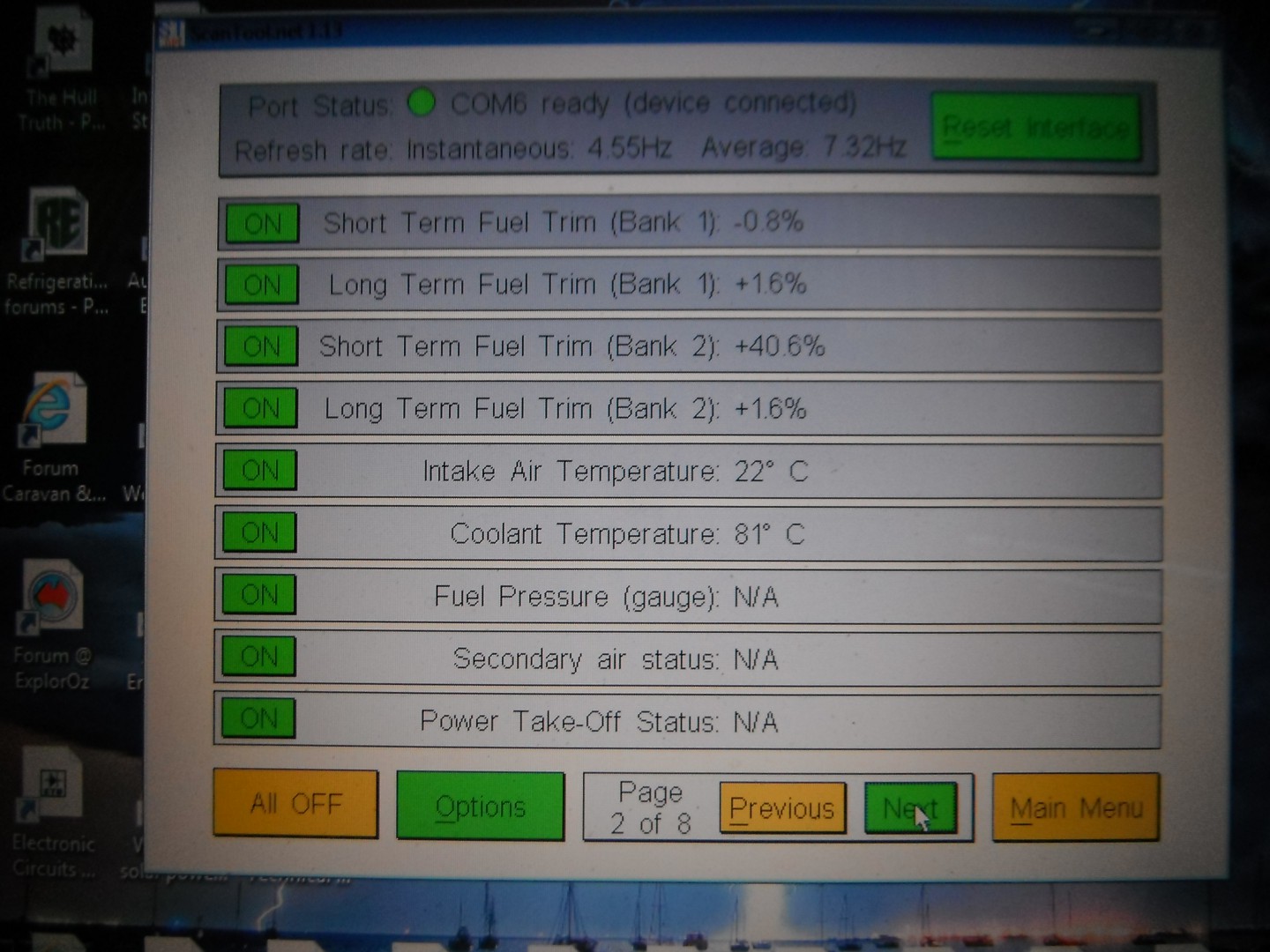

This is a cheep OBD scanner, were around $15 that I use. & a picture of what the socket on the vehicle looks like. It will be with in reach of the drivers position under the dash usualy by the fuse block. It will read codes & erase them.
Another reader which was around $30 you can plug into a laptop USB & read codes & erase, also gives real time data when engine running & very easy to use. ELM 327 reader. Pictures are on A Ford BA Falcon with the engine running.

oldbobsbus said
06:56 PM Dec 10, 2013
Just a point to remember,...
All OBD II scantools dont read ALL vehicles..
I have a VT commodore and a 2002 Pulsar and I bought a cheap Scantool OBD II and it wouldn't read the codes in either car...
When I contacted the seller he then told me it would only read European vehicles..
He refunded me and I put a bit more with it and got one that would do the job.

09:37 PM Dec 10, 2013
I have had two units, the first a usb interface, and the second a bluetooth unit both worked well across a number of cars, including Hyundai, Toyota, and Mitsubishi. Have not tried it on the Land Rover yet.
Couple more pics,
Thanks Plendo, while I'm only too aware of the fact that workshops have diagnostic tools I didn't know there were cheaper versions available.
Will have to look around for one to suit the Transit, are there different models to suit various vehicles or are they a one size fits all arrangement?
Thanks Bob, I had a feeling this may be the case, will have to do some research.
They will read pretty mutch any thing after 2005 Asian & Ausie vehicles. Anything before 2005 is hit & miss, but at $15 its not a huge outlay.

OK folks, time for an update. After a couple of days in Esperance, we found it harder and harder to start the engine (the ambient temperature would not have been an issue). The engine was turning over but not firing. The glow plug light still only comes on AFTER the engine has started. One day, after 10 minutes, it finally started!
I took it to two mechanics who between them, tried 4 different diagnostic tools plugged in and not one could communicate with the Merc! (They both suggested I take it to a Mercedes Dealer who, unfortunately, happens to be 700kms away!). Anyway, one morning I really struggled to get it to fire and only after a huge amount of throttle would it do so. I took it to a mechanic (again still in Esperance) and he noted that there was fuel visible around the top of the injectors that shouldn't be there. His assumption was that the 'return fuel lines' were perished and had been leaking out under pressure and so he replaced them (they are on top of the engine at the injectors). Anyway, the next day, after 12 hours idle, it started fine and I thought the problem had been fixed. However, the very next day and the same problem has arisen (the top of the injectors look fine and dry). The engine turns over but REFUSES to fire without a heap of throttle. I'm now at a loss as to what to do. I still believe the issue is with the glow plug relay module and I told the mechanic this but he didn't seem to know a lot about them....
If anyone has any ideas as to why there should be fuel around the top of the injectors, then all advice will be taken as this is driving me insane!
Thanks in anticipation......
