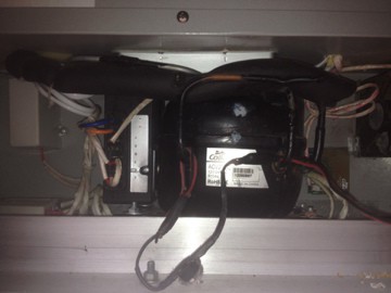

07:50 PM Dec 8, 2013
hahaha sorry didnt mean to lough but its sort of a private joke about fans and fridges
i have a compressor fridge and fitted 3 small fans to the bottom vent . the reason i put it here is the fins on the vent turn the air up at about 45% thus not realy getting air to the bottom of the fridge some agree some dont . but ya get that

mr glassies said
09:33 PM Dec 9, 2013
well there ya go there isnt any condenser or fins out in the open on my fridge . i just wanted to move the air from the bottom to the top and run it over the compressor up the side of the fridge and out the top vents .
i was just explaining how if its pulled from the top the air will/could have a dead spot at the bottom of the fridge because of the way the vent is built .

well there ya go there isnt any condenser or fins out in the open on my fridge . i just wanted to move the air from the bottom to the top and run it over the compressor up the side of the fridge and out the top vents . i was just explaining how if its pulled from the top the air will/could have a dead spot at the bottom of the fridge because of the way the vent is built .
dibs
A fridge that does not have an External condensor ??I' d like to see that
Perhaps you could tell us the brand & model ?
Perhaps you simply mean it does have a condensor ,BUT it does not protrude outside the case ??
The Condensor cooling is what affects the fridge cooling ability!!
The compressor temp is not a problem as far as cooling abilty is concerned.
Simple facts!!
if you had put your glasses on before you read my post you would have seen what i wrote and i quote my self .
(well there ya go there isnt any condenser or fins out in the open on my fridge)
im not very well educated and i dont talk about things idont know about unless im asking questions so i can learn . but when someone puts s&^t on me i will bite back. look very carefully at the 2 pics below 1 is of the compressor and the other is the back of the fridge looking from the bottom up .hhmmm i mite even add a website of the fridge
if you can point out a condenser or fins in those pics i will buy a slab at the next happy hour
you also mention and i copy and past (The compressor temp is not a problem as far as cooling abilty is concerned.)
if this is true why do the factory put a fan blowing onto it sorry i didnt get it in the pic but its on the rite trust me. now remember this is a question about what you wrote
also note the wire hanging down is the temperature or thermo switch

oldtrack123 said
08:35 PM Dec 10, 2013
HI Glassie
Again I asked the question what model!
You did not seem to understand THAT is always important with fridges[like oils all fridges are far from being the same]
Not that an Ebay special name means much since dozen of different names get plastered on the same fridge model to suit the sellers
Your link does appear to work[ ERROR 404 cannot be found]
& I cannot realy see much from your pics
but IF your fridge has a false back, air path from bottom to top THAT is where the Condenser is
IT then is exposed Not sealed in the skin, as Bob's is with no provision for either natural flue effect or added forced cooling,
In very hot weather a fan would assist COOLING EFFICIENCY IF your's is as above
Even compressor fridges have a temp limit, at which they struggle to work efficiently,due to the REFRIGERENT being TOO hot when it enters the evaporater
I cannot see the actual fan or where it's air flow goes
But I have already said ,some makers may cool the electronic controls & even the motor ,IF they are pushing them to their Temp limits
That is generally a max of 50C , but can be as high as 75C depending on the design
I would be interested in knowing IF your fridge has a vertical AIR shaft at the back , which would then be there to give a cooling air draft over the condensor .
But none of this is /was ever relevent to the OP's question. his IS an absorption fridge , no motor ,totally differnent operating principle
PeterQ

Funny that i cant recall any comment about cooling of electrical s .and like i said if you had read my post you wouldnt have had to make any comment on what i said
THAT IS THE POINT I WAS TRYING TO GET ACROSS TO ANY BODY PUTING A FAN OR FANS BEHIND THERE FRIDGE
you were the one that jumped on me
igive up waisting my time

http://www.ebay.com.au/itm/LARGE-142-LITRE-DC-FREEZER-FRIDGE12V-24V-240V-SOLAR2013-MODEL-/111233218255?pt=LH_DefaultDomain_15&hash=item19e60436cf&_uhb=1

HI Glassie
