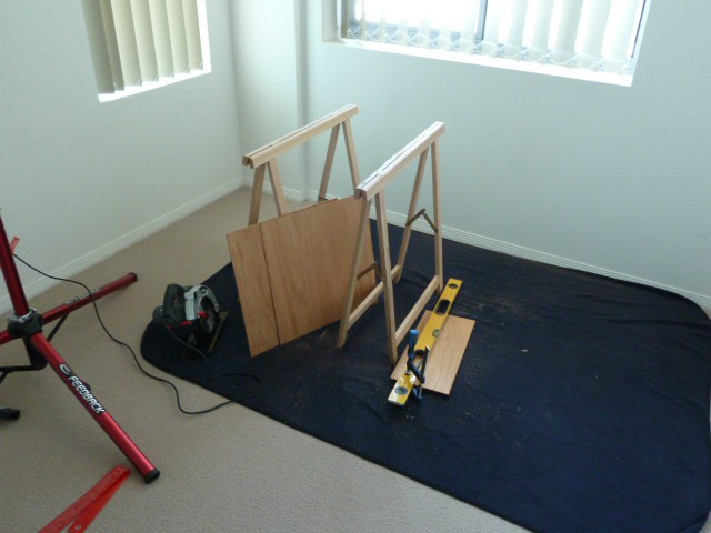

A few days ago I could luckywise pick up the equipment I've ordred from www.ozefridge.com.au and today it was time to start building up my own fridge. Because it will take a long time until I have the money for the Van together, I thought I start with something that will keep me busy and makes the time fly.
Went to www.boatcraft.com.au today to pick up the materials to start and turned one of my bedrooms into a sawmill. Was a very nice experience to deal with them and I'm looking forward to go there again. Very helpful.

Find a few pictures of my workshop attached.
Regards, Berni

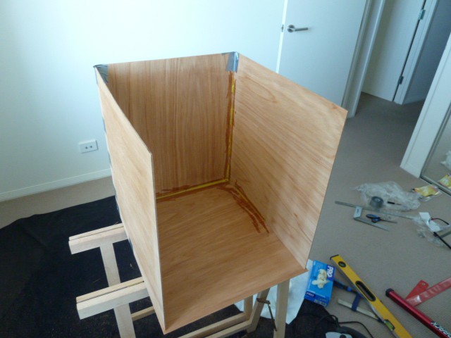

Started glueing the first bits together after sanding. Have to do it in three steps because the sheets are slightly like pancakes and I want it to be as accurate as possible. So that was the job for today.
Regards, Berni

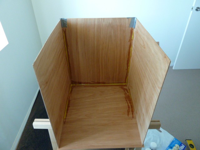

A good day so far. Came home from night shift, watched my team how they made a draw in an away match against our worst enemy, went for a shopping spree to Boatcraft Marine after that and got all the missing bits and pieces.
Just finished the final glueing and will start sanding the outside in a few minutes, enjoying the sun on my balcony with a beer or 10 .
Regards, Berni
-- Edited by BTSV_Berni on Saturday 9th of November 2013 12:37:10 PM

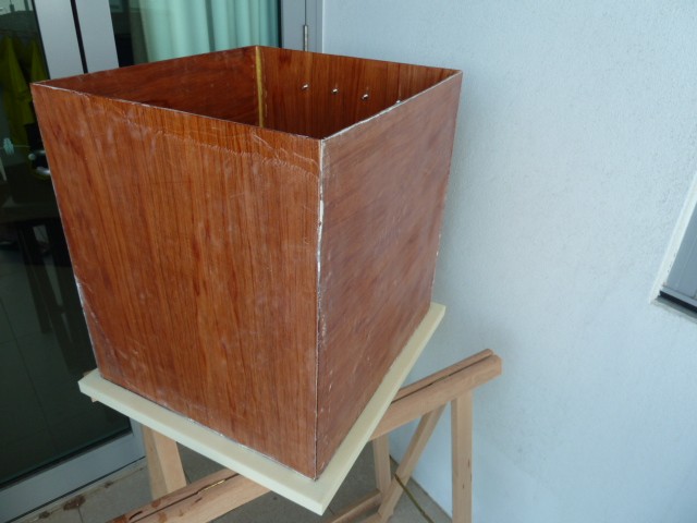

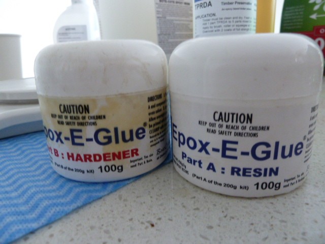

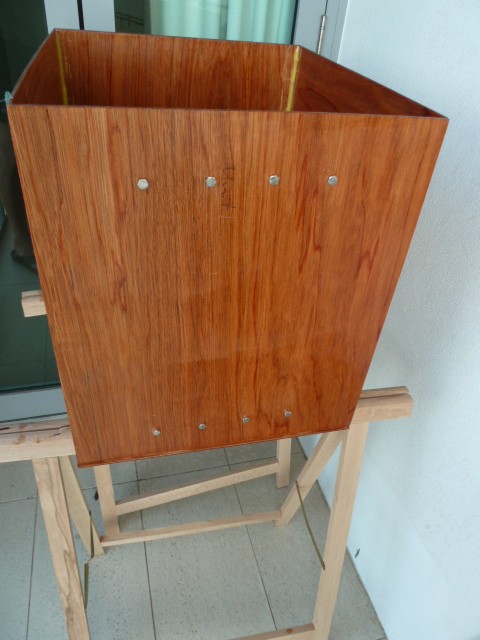

Yesterday I did the inside and today I apply on the outside a thin layer of Bote-Cote epoxy mixed 2:1 (as recommended) with an addon of 10% of Bote-Cote TPRDA to make the mixture a fair bit thinner. So it will go deeper into the wood. On the picture you can see the before/after.
To apply that stuff I use quite cheap chinese brushes. No matter at that stage if they loose a few hair left in the epoxy layer. For the final touch later I'll go for better brushes. Would be a waste of money at that stage.
Decided to use the time the first half of the outside epoxy needs to bond so that i can turn it around and do the second half. Made up a template for drilling the holes for the holding plate which will happen tomorrow.

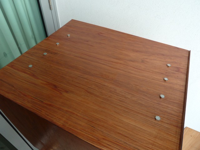

What a fantastic day it was. The weather was outstanding and a slight breeze made a few things happen much quicker than I thought. So I was able to use the template, drill the holes, put in the holding plate, line everything up and glue the bolts into place. The template was perfect. No adjustments needed.
Glued the hex heads into it and tomorrow I'll see if it lasts. There is nothing more worse than having everything done and in place only to discover that the bolts are turning where you don't want them to turn. Last chance to fix it if it doesn't last or line up.
That means that I can start with the insulation tomorrow.....after I've picked it up . love it.

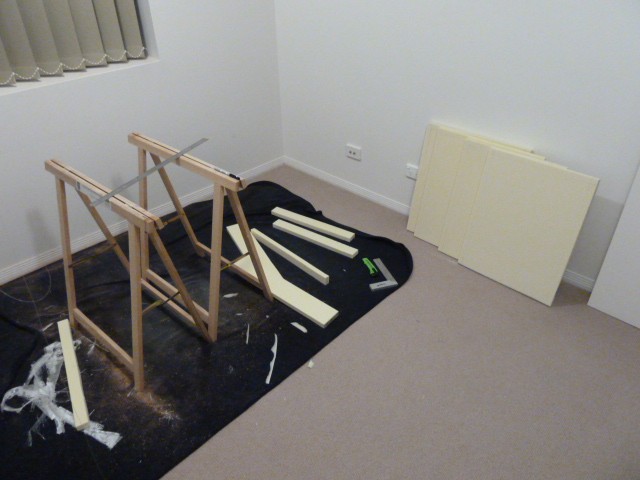

Went to Vanglass/Freezefoam to pick up the insulation. Nice to deal with these guys. Then I tried my first two layers of fibre glass in my entire life. Lot's of room for improvement. One hot advice. Never, never, never ever try that in windy conditions on your balcony. I hope, that my skills will be significantly better if it comes to do the box inside. Outside is no big drama.
More layers are done. One missing. Overlap becomes better. Picture shows before overlap is done. Works better if it is not too fresh. Folding over and rolling on after one hour is doing the job.
So tomorrow the final touch with a bit sanding the corners and then it's time to put the insulation on.

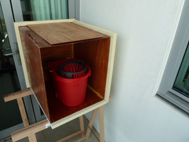

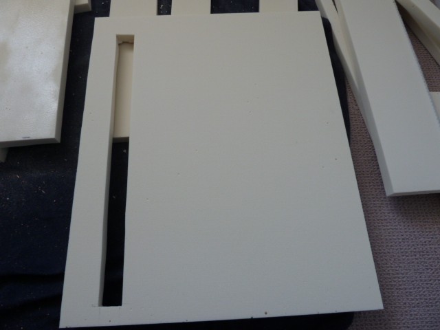

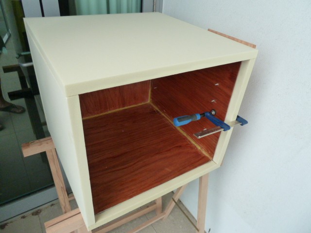

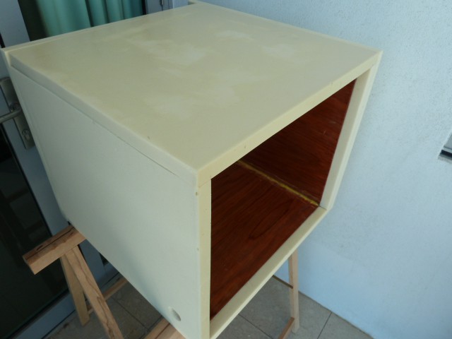

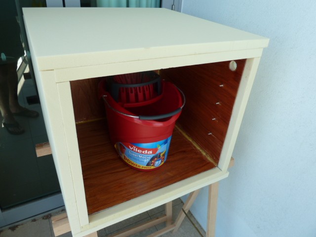

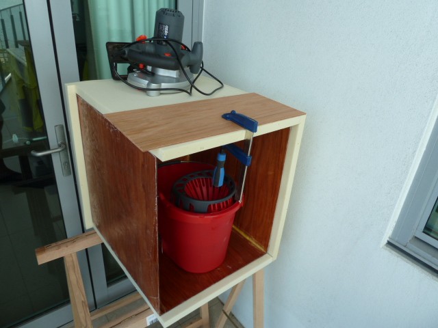

Went further today with putting on the insulation. The last missing sheets will be cut and prepainted in the evening to be ready for tomorrow and then I have a lot of mess to clean up and have a bit a break.
Also drilled the hole in the box for the pipework and made a gap in one of the sheets where the pipework is going through later on. I want it to be easy to maintain if things go wrong. So the insulation in the back where the holding plate is sitting will be a bit tricky.
It looks pretty good so far mate. Just wondering why the use of wood on the interior, instead of something like aluminium or acrylic sheeting? Incidentally, we've been building a bit larger "ice box" at work lately. Approximately 3.5M high X 4M wide X 6M long. Using 50mm foam sandwiched between 2 layers of colourbond type steel. The boss thinks it's a spray painting booth, but we reckon we'll fit a heap of grog in it. Just got to work out how we can disguise the chilling system as an extractor fan with filters.
BTSV_Berni said
04:55 AM Nov 16, 2013
I used wood to give a bit of extra strengh. The holding plate weighs completely filled and ready roundabout 5Kg. This is a fair bit of weight pulling on the nuts in a moving vehicle. I think a U-shape would have done the job too. Aluminium is a very good conductor so it's not a good idea to use metal for this job. As good as it transfers the cold........it's doing the same with heat.

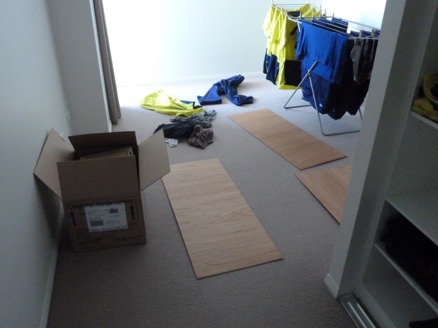

Hi guys
Regards, Berni

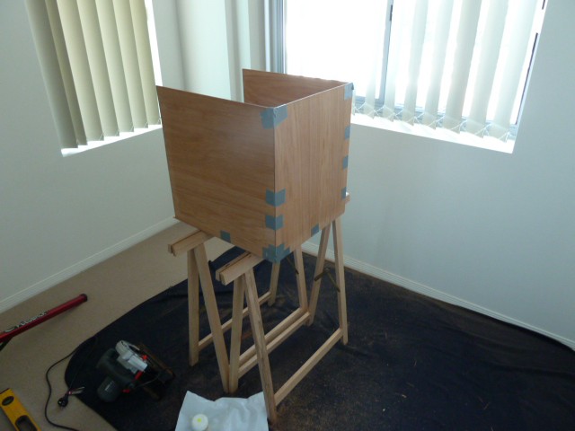

If you go to the boatcraft workshop in Loganholme directly you get it for tradies prize. Saves good money. No handling, no shipping, no dramas. They pass the savings onto you. Worth 25-30%. And they provide you with lots of good tips and tricks how to do things. Will be there again next weekend.
Regards, Berni

Box is now having its shape. Final touch will happen during the week.
Regards, Berni

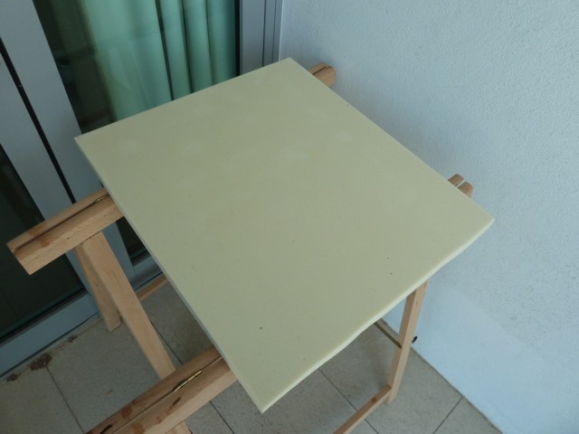

Further investigations are done related to the insulation foam and I'll end up
with Vanglass/Freeze foam in 80kg/m3.
Compared quality/pricing of Dow, Multipanel and Freezefoam and Freezefoam
is the winner.

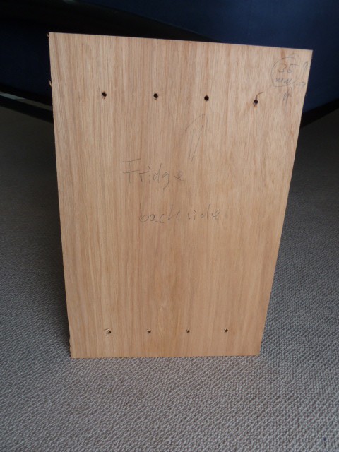

Regards, Berni

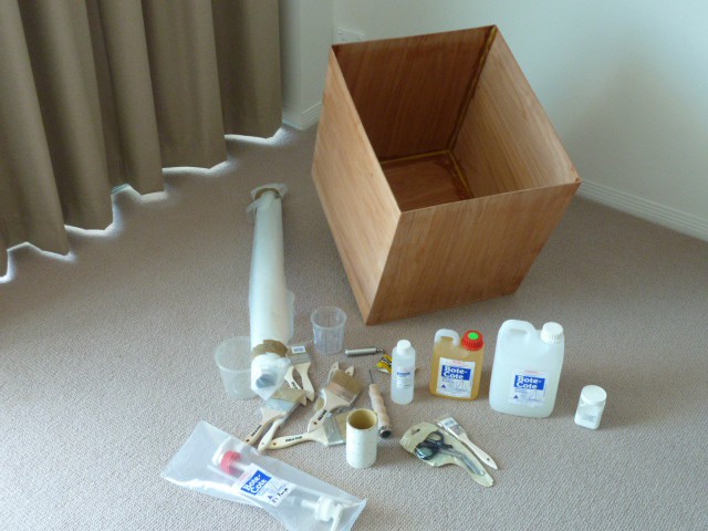

Regards, Berni

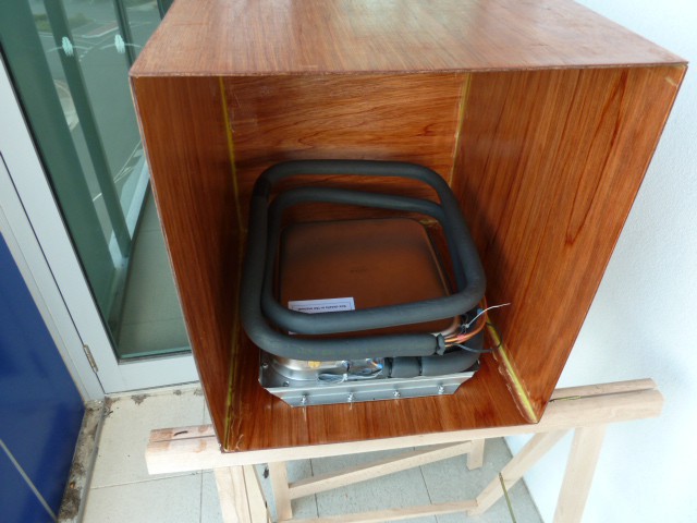

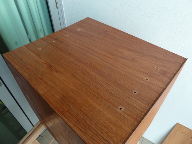

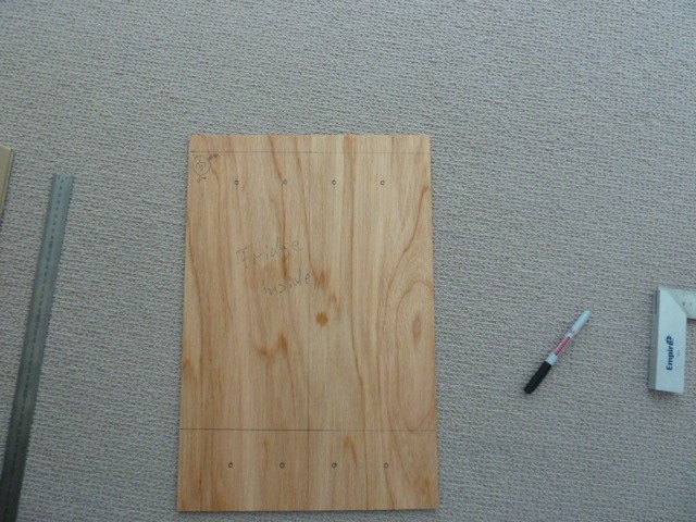

Regards, Berni

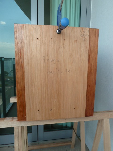

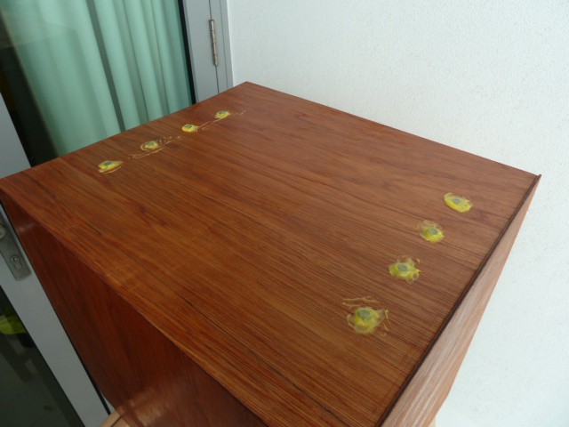

. love it.

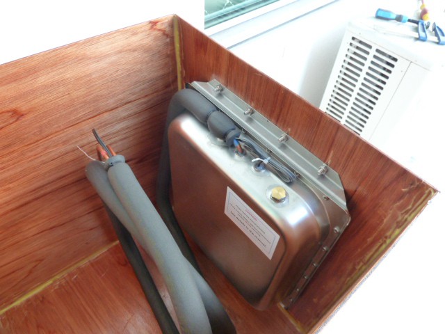

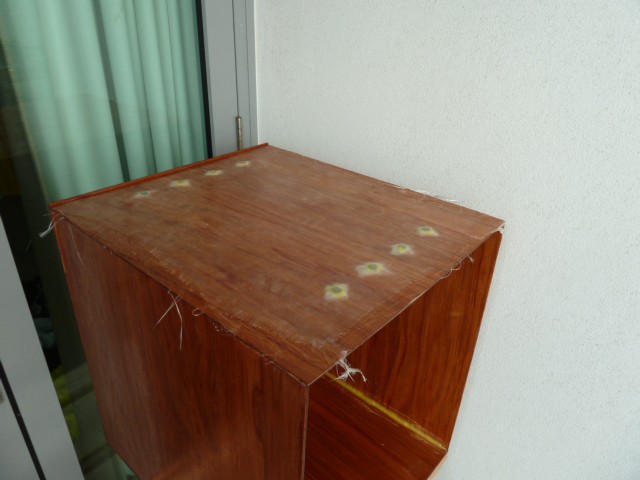

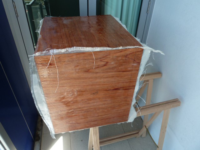

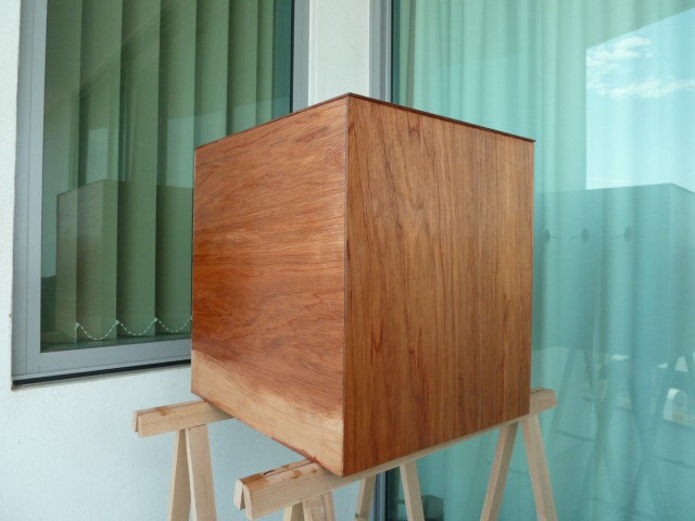

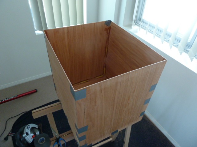

Regards, Berni
Regards, Berni

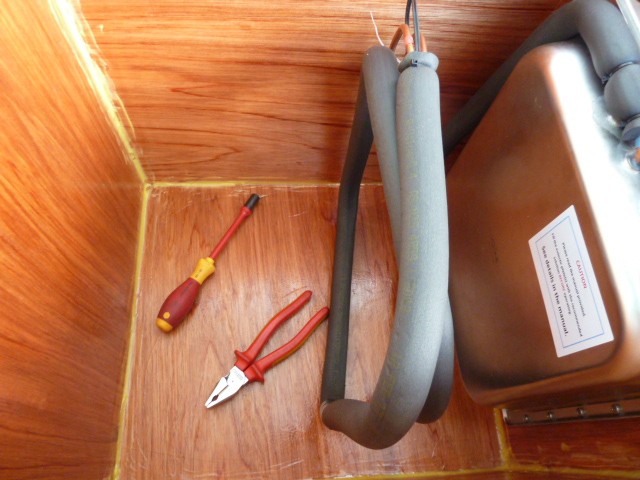

Project is growing further. Got the sanding of the corners done, cut the first bottom layer of insulation and coated it with a thin layer of Epoxy mixed with 10% TPRDA to make sure that the glue bonds properly. This will be done with each layer of insulation. Time consuming but I think it's worth the time. Good thing is, that the insulation can be cut very precise with a knife. Exept of the 4 first side layers, where I have to cut a 45 degrees angle, the circular saw can stay in the box. Less dust and mess.
Regards, Berni

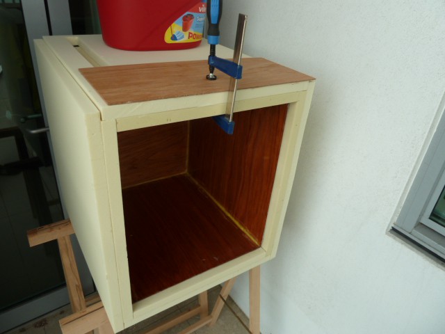

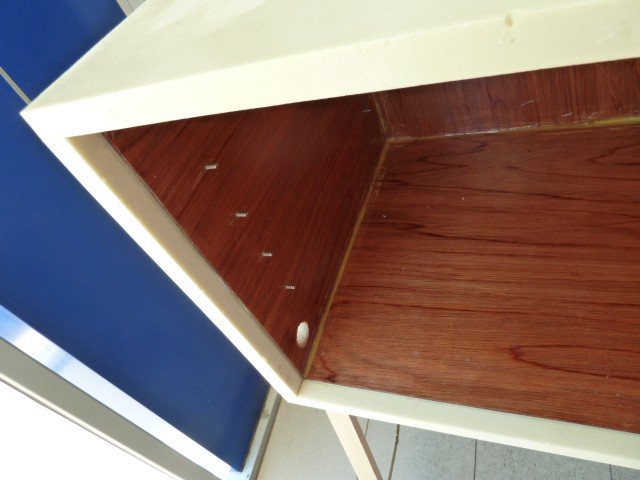

Regards, Berni
Your fridge dimensions sounds good. Lot's of room for beer.
Regards, Berni
