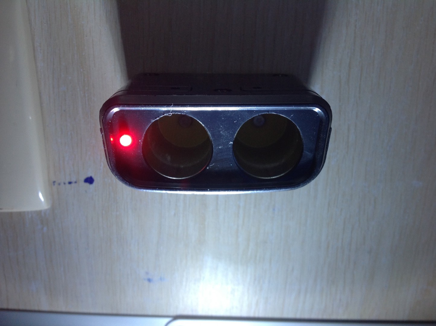

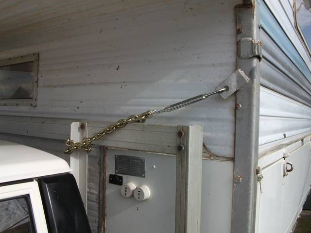

Well, well, well, I have two external plugs like those on the front of my camper (connected to the AGM). There's a regular ciggie lighter type next to them with a rubber cover.
Is the AGM your auxillary (house) battery Gary? My single socket has the same ciggy type as your too alongside it with cover over it.
So what do you think yours was used for? Watching TV outside etc?????

GaryKelly said
12:26 AM Jul 7, 2013
Yes, Vic, the AGM is the house battery (connected today with the inverter, etc). The auto electrician said the two white plugs were 12V but didn't say what they were used for. I figured maybe an external shower or whatever. I'll ask him next time he's here to connect the rear view camera and solenoid. Inside the storage bin, which houses the AGM, are another two ciggy lighter outlets plus a power board (for mains).

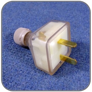

dorian said
03:24 AM Jul 7, 2013
Square plug, round base. Hmm ...
06:22 AM Jul 7, 2013
There is no official standard for the polarity of these connectors. I would suggest metering them to check their polarity before connecting things to them.

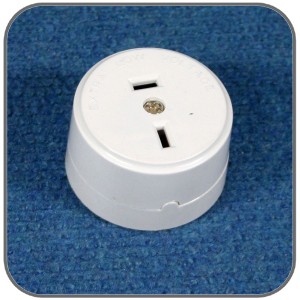

Olley46 said
06:54 AM Jul 7, 2013
If you have a good close look at these plugs it states low voltage only,they are 12 volt I have replaced mine with a double cig lighter twin power outlet,may get used one day.
"Flexible Plug, extra low voltage (32V) 15A configuration, two polarised pins, 8.7mm cord entry size, suitable for 0.75mm and 1mm ordinary duty three core flexible cords."
"Note: Where the ELV (extra low voltage) supply is referenced to Earth, the radial pin should be the Earth pin. Outside of these situations it is recommended to consider the radial pin as Neutral and the remaining pin as Active, although these connections can be reversed."
The base is referred to as a "surface socket", cat number "402/32" (page 28).
"Front Connecting Surface Socket, 32V, 15A, two polarised flat pins, 4.8mm live contact terminal bore to accommodate 4 x 2.5mm cables, suits 492/32 plugs"

BTW, Clipsal's version of these plugs is cat number "492/32".
Just looking at the pic on your original post Gary, I know the ciggy socket has a cover, but notice the two T plug have no cover on the and are facing forward on the front of your slide on, so driving into driving rain could present a problem. When you have the other work done, ask the sparky if they are ok like that or should they have covers?????

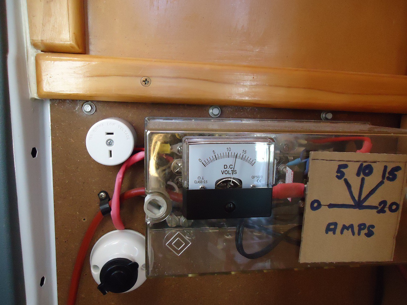

12:46 AM Jul 8, 2013
Duh wrote:The cardboard indicator stuck to the amp meter box was put on by me as my eyesight is not too good and gives me a rough idea of the reading of the needle without using my glasses or squeezing in closer.....by the photo's looks like it's showing about 13 amps at present.
To me it looks like 12.5 V, not amps.

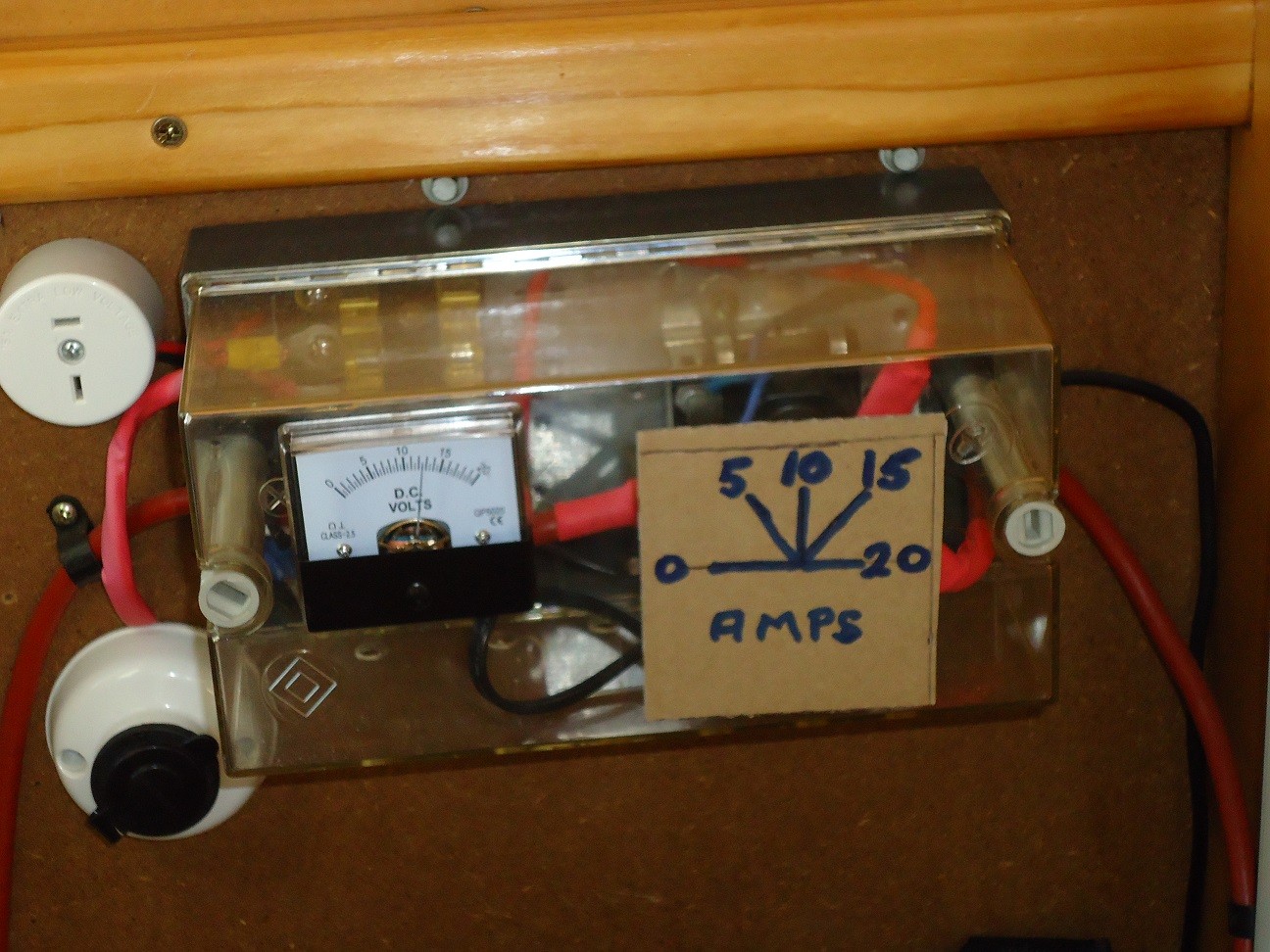

justcruisin01 said
02:23 AM Jul 8, 2013
Looking at your pic the two plugs are power supply for accessories, you can see the wiring entering the plastic box & going to a fuse block.
JC
Duh said
04:44 AM Jul 8, 2013
Yes, sorry for the confusion Peter, you are dead right, even written on the box, sheeesh, I'll have to change my sign to read volts instead of amp. Thanks for pointing that out!
Duh said
04:48 AM Jul 8, 2013
JC
Thanks for that JC, what sort of accessories would you run off them? Would you be able to run a 12V TV and if so for how long, assuming the auxillary battery is full charged ?
justcruisin01 said
07:35 PM Jul 8, 2013
JC
You can run a variety of things such as portable lights, fans, fridge,tv, anything that has a lower power draw.
As for how long that has to be determined by the size & condition of your battery, then calculate the amps being used as in what is stated on the accessory's.
This will give you a indercation of time, however there is no golden rule as to how long because there is no perfect world.
One thing to remember is that when a battery's volts drop the amps usage will increase a little to compensate the lower volts, therefore hard to state an exact time frame.
JC
PS, dont try to run an inverter from these points, it will need to go direct to the battery.

Near my auxillary battery, I have a ciggy type plug for 12V accessories and also another which I think may be for a TV.
However the socket has two oblong pins, one horizontal oblong one at the top and a vertical oblong one underneath it.
Although not touching, the two oblong pin holes are in a "T" Shape.
Can anyone tell me what they are for please, and also where the corresponding plug for these would be bought?
Thanks

Does it look like this?
http://caravansplus.com.au/catalog/product_info.php
... and the plug:
http://caravansplus.com.au/catalog/product_info.php?products_id=9110
-- Edited by dorian on Saturday 6th of July 2013 07:40:40 AM
-- Edited by dorian on Saturday 6th of July 2013 07:41:58 AM
Sorry, the first link should have been ...
http://caravansplus.com.au/catalog/product_info.php?products_id=8446
See page 18 of the catalogue:
http://updates.clipsal.com/clipsalonline/Files/Brochures/A0000123.pdf
Here is a complete range, including wallplates and weatherproof versions:
http://www.12volt.com.au/General%20Htmls/webcat2003/plugs2.html#plugs
-- Edited by dorian on Sunday 7th of July 2013 07:29:09 AM
-- Edited by dorian on Sunday 7th of July 2013 07:30:49 AM

Will have a closer look at the socket and try to get a pic of it (in a tight spot behind a seat and behind a cupboard) both the T socket and Ciggy socket are near a fixed amp meter inside a Perspex case which is over the top of an auxillary battery. Reading is about 10amps at present, possibly 12amps, a bit hard to read.
I have a lead made up to go from T plug to Cigarette socket , mine too is behind a seat , hard to get to, but directly above house batteries. I've plugged numerous things into it, all have worked fine.
Thanks for the info and product link Dorian, I am no techo and not techo minded, but it will be of help to other members who are.
The previous owner of my van was an electrician, so I guess whatever was put in there was done properly. Unfortunately I have not been able to contact him, the dealer I bought it off told me. I may have to get a sparky or auto electrician to look at it sometime.
Again, Thank you.
Thanks Goldcoaster, I am not following you, are both the cig socket and T plug outlets, if so why does the T plug have to go into the cig socket? I'm just a bit confused. Below are a couple of photo's of my sockets and amp meter, one of the main leads go from the aux battery to the vehicle battery (left side looking at) while the right side (looking at) has a heavy lead that appears to go to the fridge and possibly other 12 lights etc in the back of the vehicle. The previous owner of the vehicle was said to be an electrician.
JC
JC
-- Edited by justcruisin01 on Monday 8th of July 2013 07:37:16 PM
Thanks JC, that gives me some idea of what to use them for, albeit for brief periods without solar, generator, driving or 240V battery recharge facilities...
