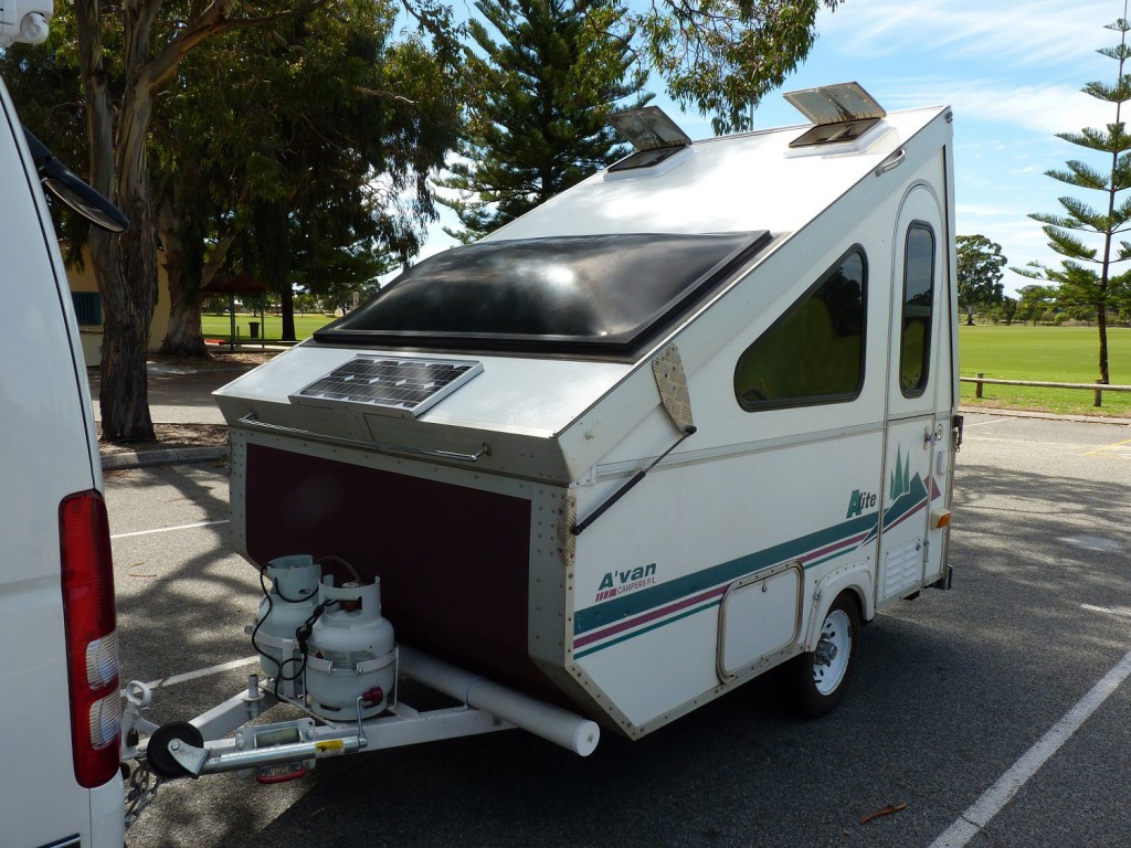

I see on that site a pic of the American version of the Australian A'lite I used to have, some differences.

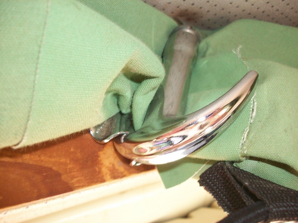

I will get a photo of my hooks when I get dressed Sheba. I thought yours would be the same. I don't have solar panels on the roof so it is fairly easy to push up.

06:16 PM Mar 17, 2013
This is the hooks on my pop top to hold it down. There is one in each corner. Not sure if anyone has the same.

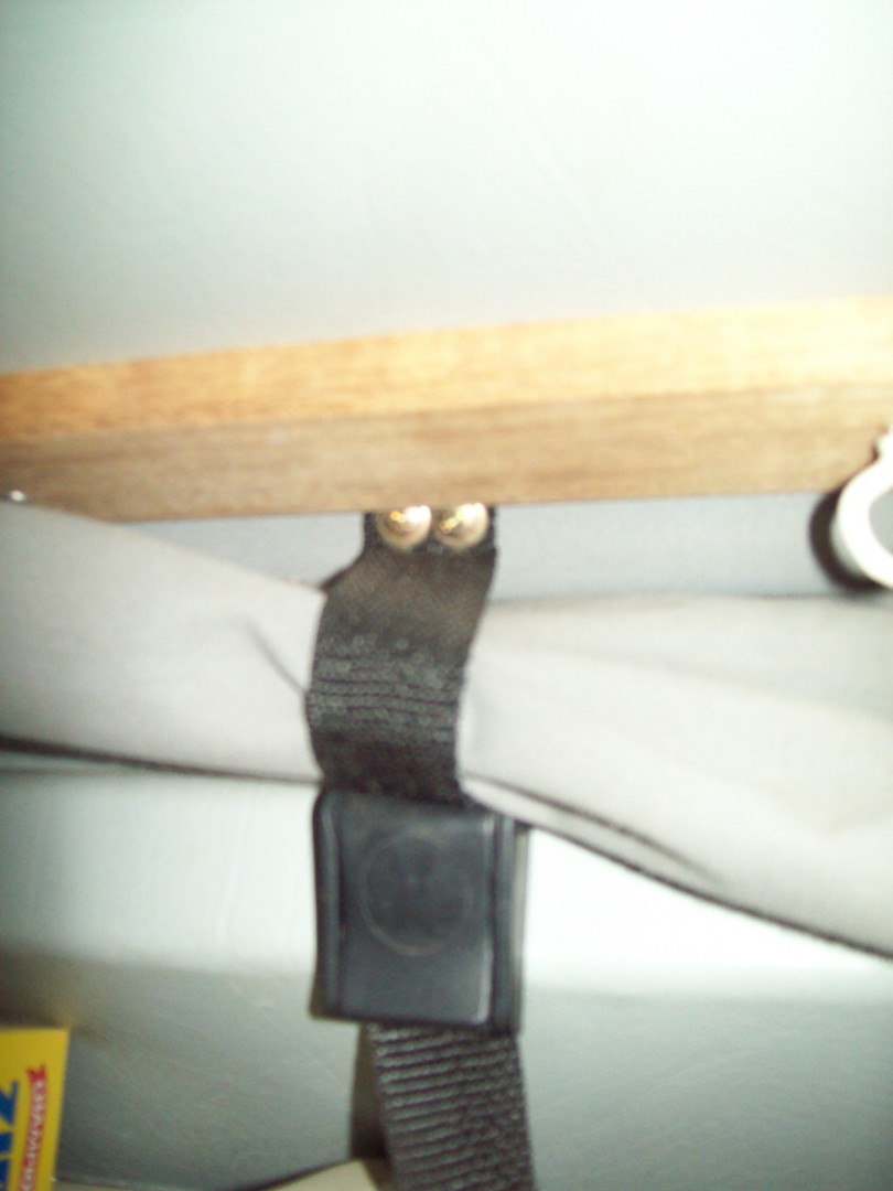

Sheba said
05:36 AM Mar 18, 2013
This is how mine is held down. There are either 4 or 6 of these. I may not have done the 2 middle ones up last time. You'll see what I mean when I come down Marj.

Thanks for posting the photo of the clips.
