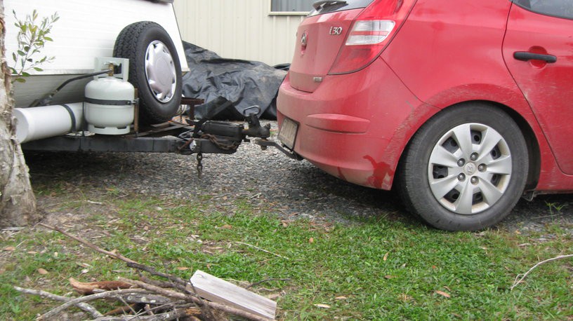

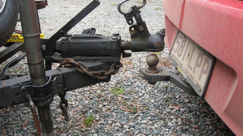

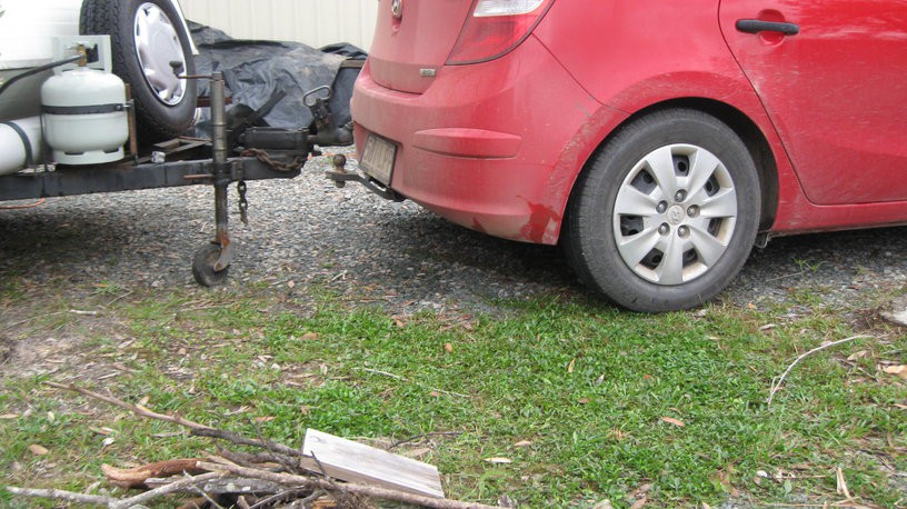

Okay Techies, I'm looking for advise. When the caravan is level, the hitch sits about 60mm higher than the towball. When it's hitched, it's lower, but it doesn't seem to 'sag' the back of the car so much as it's just 'downhill', if that makes sense.
I've been researching, and 'they' say I need a weight distribution hitch, but I don't think weight is the issue, but the fact that the towball is too low.
When I arrived at Cobb & Co I couldn't even get the jockey wheel clamped into place because it was sitting so low. Rowdy Rabbit put a jack under the draw bar and lifted it enough to get it fitted.
In the unhitched photo, the van is level.

would also like to see a picture of you whole car with van attached from the side to me it looks like yor car is also going down with the weight about 30-40mm ( WDH would solve this or upgrading your suspension) going by your measurements your tow bar hitch does need replacing with one that is 60mm higher

As you have a FWD car you really should have a WDH. When you drop your van on the ball this not only drops the back a little but it raises the front. The resultant reduction of weight on the front wheels reduces the traction, braking and steering performance.
As your van has over-ride brakes I would suggest you don't use the shepherds crook bars as the friction of the bars on the 'J' cradle on the drawbar will impede the over-run brake operation. I would suggest http://caravansplus.com.au/catalog/product_info.php?products_id=8588 instead.

I'm inclined to go along with PeterD's solution as it will level the vehicle (more important than the van) and, more importantly, distribute an appropriate proportion of the van's weight to the front axle which, as Peter points out, is the driving axle.
If you intend seeing the towbar supplier (as implied in your previous post) it may be worth running this idea past them as it seems to be a relatively inexpensive fix.

I think you are right the towball is too low for the towhitch on the van.
Not sure of the legal issues so would advise going to your RACQ or other club if you belong to one and ask for their advice.
I had to buy a lower tow tongue to keep my tow level so maybe just a higher positioned towball would be OK.

Most towbars these days have detachable tongues and you can buy a range of different height ones, Consult one of the tow bar specialists in your area and they should be able to advise and order the correct tongue for your situation.

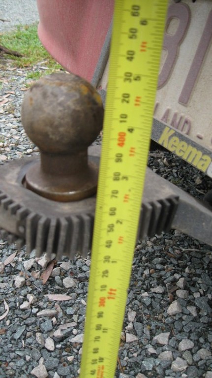

It's difficult to comment as the vehicle and van are not on a flat surface such as a concrete pad. While the ball appear to be fairly low the tape measure says it 415mm high, so I'm guessing the end of the tape maybe in a sight depression in the ground. Place the vehicle and van unattached with both level on a level flat surface and remeasure the height to the centre of the ball and the centre of the coupling. Once the correct dimensions are known a solution to your problem maybe possible, but I'm thinking that without an adjustable tow ball tongue or similar you'll will probably be stuck with a nose down configuration. Make and model of vehicle would also be of assistance. Cheers, ozjohn.

Snapper49, yes, it does drop a little. I've already put bigger springs in, but I also suspect I need to be a bit more conscious of weight distribution. I had brother-in-law and sister...who are very experienced...helping me load, so I thought it'd be okay.

It seems to me , from your photos, that you need some way to raise the back of your vehicle. Does it have coils or leaf springsin the back? Pump up shockys could help raise the back of the car, with some hardness in the back suspension the only drawback. My courier has helper springs and they make a big difference. Front wheel drive vehicles are not as good for towing as the biggest springs are on the front of the vehicle.Having the caravan and the vehicle on the same level makes everything line up easier, and also looks better.I hope this helps you. Bill

I'd actually come home from Cobb & Co thinking...not for the first time...that I need to change my car. I'm really reluctant to do that because I've had this car from new, and know everything that's been done to it.
Thanks Jim. Always good advise from you too. Yes, I think I'll go talk to Aranda tomorrow.
being a nipper your A frame will be very light in construction and will need under trussing to take the force applied by levelling devices
Also airbags shouldnt be dimiseed
I have HD coils on the back of my terri and have put airbags in to support the coil springs
Excellent performance
Very true Marj.
Yep, I realised that Marj.
You have to have some safe clearance, while keeping your front wheels firmly on the road for steering and traction.
I really think you're asking a lot of your little red car. Even if you could use a raised hitch with levellers I fear you will too close to the road.
See what sort of advice you can muster to put you in the safest position. Good luck.
Not at all, it only weighed 120kg!
What a bu**er Beth!! I know how you love your car.
Good luck at Aranda. Hopefully they can offer a solution.
Thanks Pam.
That looks to be a much heavier van with a much more robust WDH on a draw-bar that is not much more substantial than the Nippers.
Single bar shepherds crook WDH (60 kg max capacity) did not put any bend in our Nippers drawbar but it did effect the brakes a bit. The bars with chain attachment/suspension to the draw-bar were not available then.
