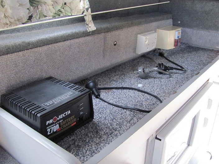

The first one shown in the picture is one unit mounted on a bench for charging the auxillary battery when on power and needs to be plugged into an A/C socket on the bench..
The next pics are two items, one mounted under one of the seats (inverter) with the other an outlet fixed to the floor nearby with two power sockets (can't be seen in the pic angle). Has anyone any idea of what this inverter may have been used for or what it could be used for please.

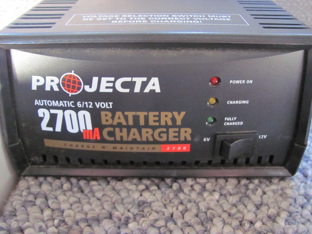

The first item (projecta battery charger) looks like one of the old common bi-metallic strip regulated battery chargers. Hard to tell, but they all seemed to be in that type of enclosure. The other two items are possibly only modified sine wave inverters, but again difficult to tell. Usually if it doesn't say "pure sine wave" on the inverter, then it is most likely only modified sine wave. If you can see any model numbers or part numbers on the items try google'ing them along with key words like brandname or inverter or such.

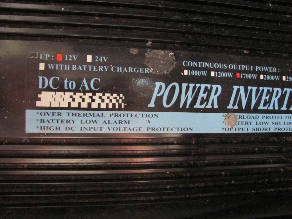

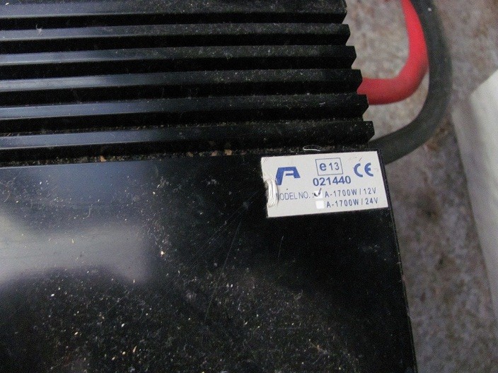

A 1700W inverter is much too big to run only a TV. You could do that with a much smaller and cheaper unit. Depending on the size and type (CRT / LCD/ plasma), a TV might require 100W - 400W.
I'd say the inverter would be suitable for some types of whitegoods, eg refrigerator, microwave, or small cooker.

The battery charger is clearly used for that purpose and the surplus power going through the inverter to the AC socket when AC isn't available.

Used at it's Continuous output it will draw around 142amps
You would need a pretty large battery bank to supply THAT for any length of time
It is ok for smaller loads as it only draws what the load requires PLUS about another 10% for efficiency losses
The charger, I expect is only 2700milliamps [2.7amps]
It will take a long time to charge any decent sized battery& certainly is mismatched for the correct battery /inverter set up if making constant use of 240v

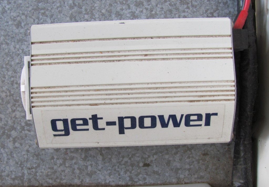

The middle inverter is a 1700W unit, so its maximum current draw, assuming 100% efficiency from a 12V source, would be around 140A.
The "get-power" device appears to be a smaller inverter, assuming that's a red and black cable pair at the terminal block at the RHS.

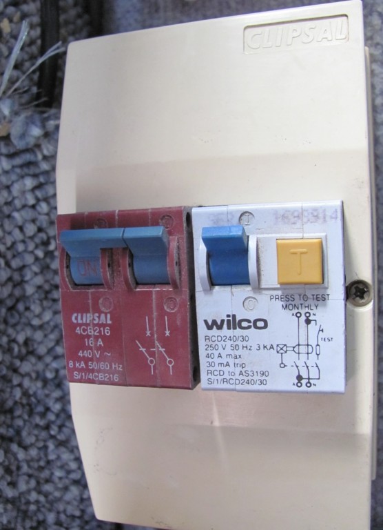

Ok you do have the required overload circuit breaker & RCD for the MAINS wiring

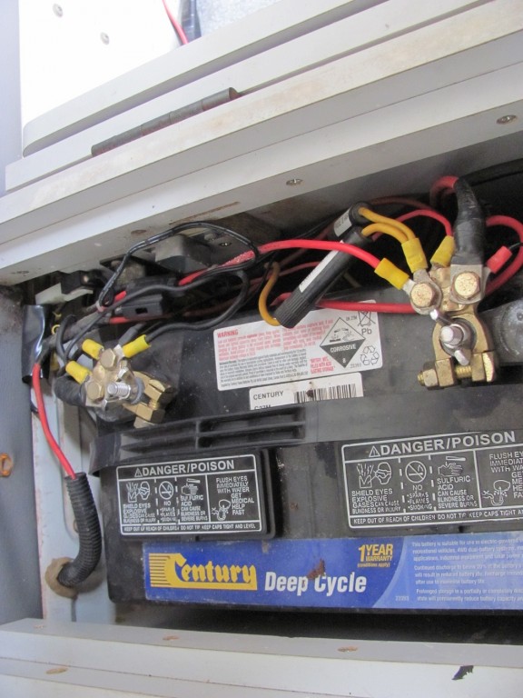

The question of the fridge recieving 12v & the battery recieving a charge,when travelling is an unkown , only testing can confirm.
Then there is still be question of heavy enough cables to maintain correct voltage @ the fridge

The "get-power" (not Get PLUS) device is too long to be just a couple of power points in a box. Moreover, a dual GPO could quite comfortably be accommodated in a cheap plastic box rather than an expensive metal one. Still another clue that the device may be an inverter is that there appears to be an exposed terminal block at the RHS. A 240VAC input would not be exposed to the end user. Instead it would be hard-wired internally.
Hi Dorian
Yes ,On looking again that does appear to be a terminal block so it probably is ANOTHER SMALL inverter.
I not sure Why I referred to it as Get plus
So the next question is what is the large 1700watt inverter feeding & how is it wired for safety
IS IT LEGAL & in accordance with the regulations
IF it is hard wired to multiple fixed outlets it should have its own RCD protection, That in addition to the incoming mains RCD. for the charger & what ever other mains devices may be connected!!
Or is it correctly wired via a "CHANGE OVER "switch ,If so where is that switch?
The logical place is the main board near the RCD & OLCB

Depending on type, having TWO seperate inverters can allow very high voltages in the van [480v possible between certain points]

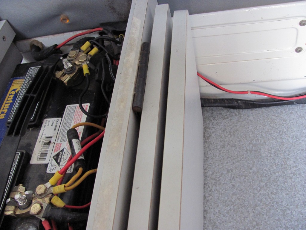

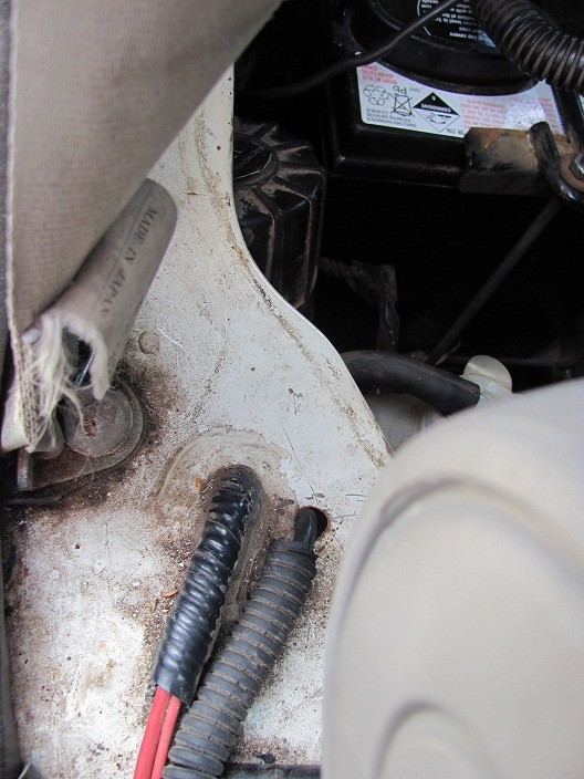

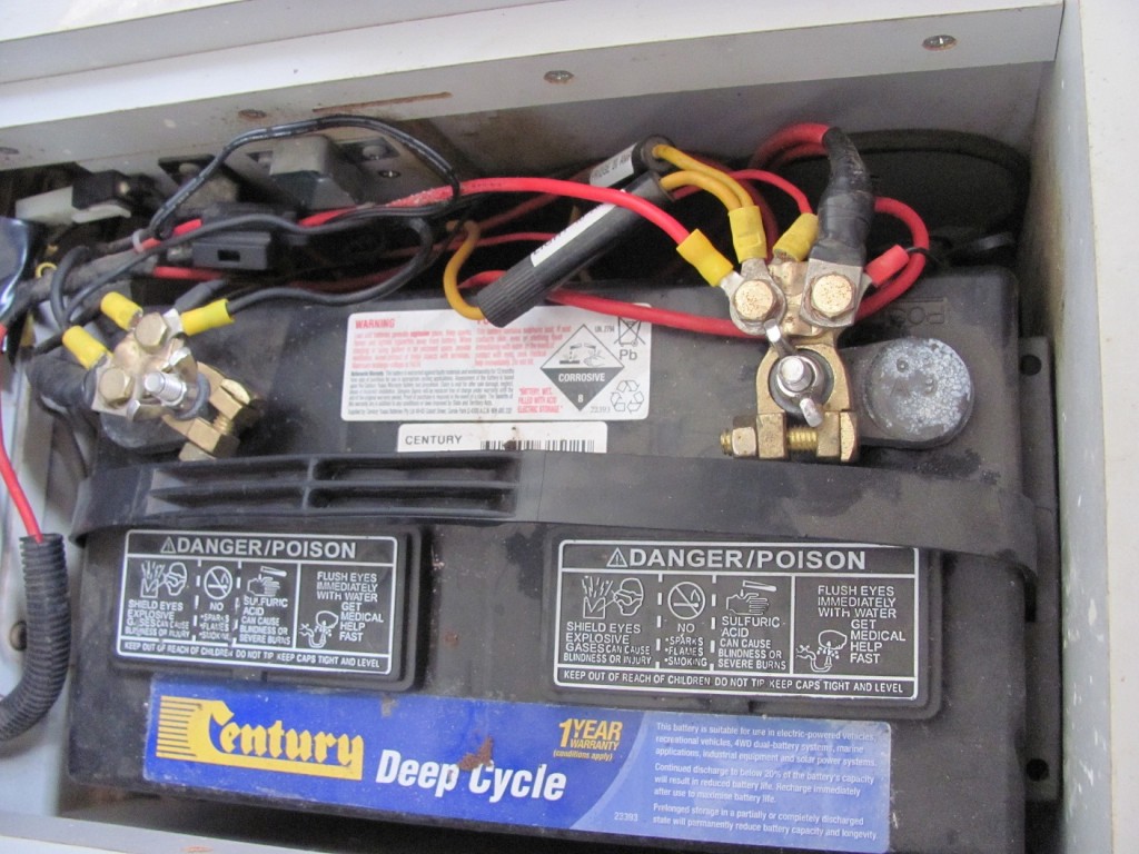

I am not techo minded so please bear with me. Here are some pic's of the various items, starting with the general van battery, separate posts for each item so to avoid confusion;

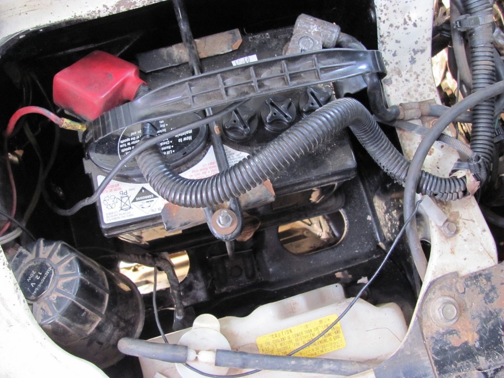

CAMPERVAN MOTOR BATTERY;
-- Edited by Vic on Tuesday 27th of December 2011 10:09:03 PM
BATTERY CHARGER ON TOP BENCH: This charger needs to be plugged into the nearby household type double GPO off 240V when on power to charge the auxillary battery (I assume).
There are three leads for only a double GPO, so need to be plugged according to item being used for Battery Charger (mounted on bench near double GPO and safety switch), Fridge (12/240V) and Microwave (both mounted under same bench).
Note: There are two double household type GPO's at the rear of the van, one near subject bench and one opposite. There is no gas to fridge, only gas stove opposite.
-- Edited by Vic on Tuesday 27th of December 2011 10:18:58 PM

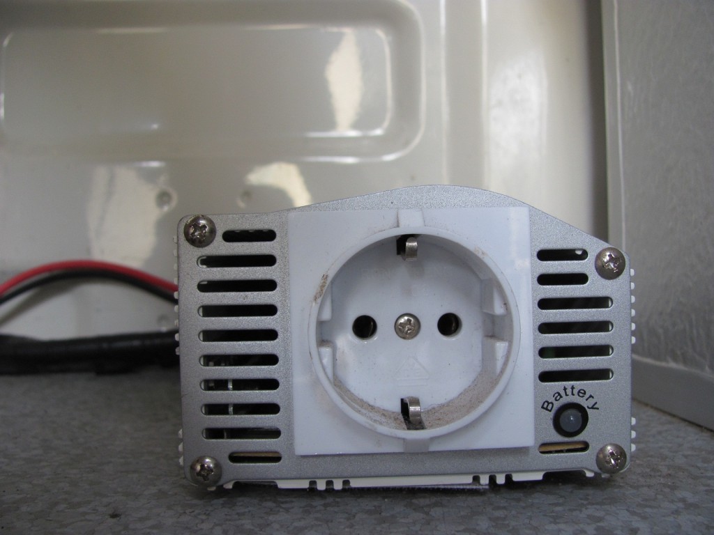

I'm not much help Vic but two things come to mind. Firstly as you have a microwave and also fridge doesn't have gas that would be the reason your inverter would be 1700 to cope with bigger electrical items. Secondly that charger in the first photo is as I supposed early like a smart charger and when you plug into mains power it will charge your in house battery. the reason I think this is the one my S in L suggested I get has the same look to it. I'm wondering if that double plug on your bench is a mains plug or a plug attached to your inverter. If its a mains plug that might be where you plug the charger into when you are connected to mains power.
10:41 PM Dec 27, 2011

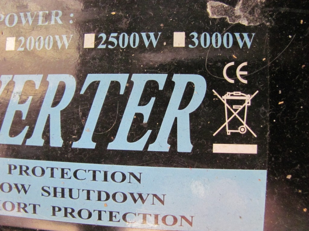

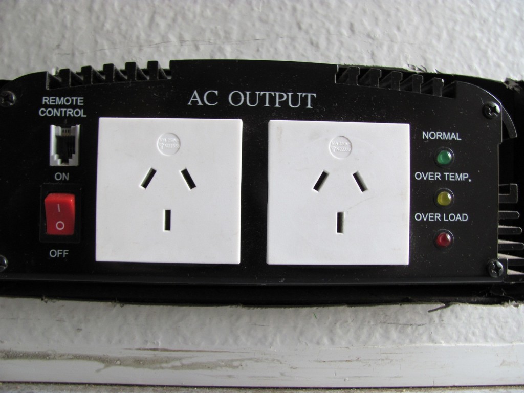

That white inverter has a two point plug hole in it. Is it made for a certain type of electrical item?
10:45 PM Dec 27, 2011
The 1700 inverter doesn't have anything written on it so I wouldn't think it is a Pure Sine Wave. It would be written on there somewhere if it was.

Yes, the double GPO on the bench is for the charger mains power, I have plugged that in when the van has been on 240V and charged the (I assume) auxillary battery, the indicator lights showed it was charging and then green when it was fully charged. There are no indicator lights shown when I unplug the mains power from outside the van, so obviously only meant for outside power source.

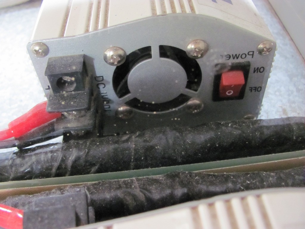

The little white box on the floor (only attached by velcro, and can be removed as I found out AFTER Carol had used a mirror to take a photo of the rear of it has a couple of plug holes too, including one that looks like a USB port for a PC.
I have no idea about the larger inverter box.
Thanks Marg for your input, it is much appreciated.

Vic the little white inverter. The back looks to be like a fan to keep it cool if you know what I mean and of course the on off switch. I think some overseas electrical items have the two round plugs that would fit into the front plug hole. I have seen an adaptor for that at the airports. Hopefully the more knowledgable people will be back on tomorrow with better info than I can give, but hope its helped a bit.
Vic said
01:17 AM Dec 28, 2011
You're not bad Marj, you know a lot more about it than I do so all advice welcome, I would be interested in what the techo's make of the pics.
I got my items mixed up, it was the large inverter near the plugs seems to have some sort of plug, it has got "remote control" or something like that written on it.
The small white one does seem to have a multi pin round socket of some kind on the rear similar to some pc's , I'll have to have a closer look at it later.
I think Carol would be quite happy just living with the charger at the moment, the other items not so important at this stage.
Trouble is when you buy something that has strange equipment in it that someone else knew what it was for is not much help if you don't know. Even the chap we bought it off didn't know what it was for, just said he never ever used them and didn't know.
Not much help there.
dorian said
06:22 AM Dec 28, 2011
The remote connector appears to be an RJ45 type. That's the kind used for networking computers together, and for some telephone devices. I expect that its function would be for remote power on/off control, for fault reporting (eg short circuit, fan failure, overload, over temperature), monitoring battery voltage and current, etc.
That said, I can't imagine why anyone would go to the trouble of fitting a special 240V inverter just to accommodate a foreign 240V appliance. I say this because it would make more economic sense just to chop the plug off the appliance and replace it with an Aussie one, or you could use a physical plug adapter. Europe runs on 50Hz just like we do, so that can't be the reason, either. My only other thought is that maybe it's a DC-DC converter to provide 24VDC, say, to some special device. But that's something you could easily verify with a multimeter. A multimeter would be a very good thing to have, BTW. In fact a cheapie should cost you less than $10.

03_troopy said
09:55 AM Dec 28, 2011
-- Edited by dorian on Wednesday 28th of December 2011 06:44:15 AM
I'd say you are right with the German style Shuko 220-240 VAC

maybe used to run a tv
Vic,
I have seen a similar set up in a caravan and the inverter made available 240 volts for any use via a normal 240 volt connection. It wasn't just used for one item say the TV it was also available for other uses simultaneously as in laptop.
Just my thoughts on the matter, the last photo suggests that it opens to reveal some override or failsafe fuseable connection.

I would think the Get plus is two outlets supplied by the inverter.
The inverter should have a 12v disconect switch as it has a standby current which will flatten the battery over time if it is not on constant charge[even though you are not using it for 240v]
More details ,model etc may allow finding what THAT particular inverter's standby current & efficiency is
There Is no indication of the output quality , PURE sine wave , or MSW[Modified SQUARE wave]
This can determine what may be safely used from it.

The charger in the first photo, I don't have one yet but S in L is going to put one in with wiring to the mains plugs so it will automatically charge the in house battery as soon as I plug into the mains and without having to do anything else.

Hi Vic
How many power points do you have ,other than those two with the Get Plus
I would still believe the two on the Get PLUS are connected only to the inverter,& that the inverter does not supply ANY other fixed power outlets
BUT what does concerm me, is that wiring I see going into the GetPus 240v from the inverter. ???
Is the inverter readily accessable to enable switching OFF in an emergency???
-- Edited by oldtrack123 on Tuesday 27th of December 2011 04:14:43 PM
Yes the inhouse battery should be charging while you are driving, that is how mine charges. And you put the fridge on power while you are driving as well.
GET POWER METAL BOX; Appears to have leads running direct to auxillary battery;
-- Edited by Vic on Tuesday 27th of December 2011 10:34:46 PM
POWER INVERTOR E13 021440 Model A-1700 12V DC to AC
(No make shown)
The "get-power" unit is a bit of a puzzle, though. My first impression was that the socket looked very similar to a European 240V type. In fact it looks like the German "Schuko socket in the following article:
http://en.wikipedia.org/wiki/Mains_power_around_the_world
http://upload.wikimedia.org/wikipedia/commons/thumb/e/ef/Schuko_plug_and_socket.png/800px-Schuko_plug_and_socket.png
