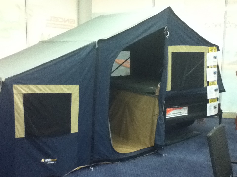

03:06 PM Nov 18, 2011
so what if i got 240 installed into the camper, like you do with a caravan, would that be better? ie thru a proper auto elctrician
this pic below is like the one im thinking of..
-- Edited by milo on Friday 18th of November 2011 03:14:04 PM
