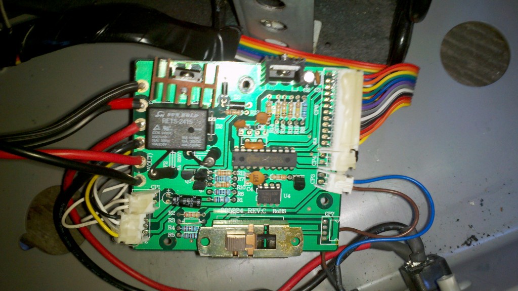

harvvectra2012 said
05:32 AM Aug 1, 2012
We have a Waeco brand electric cooler model CF-40. It came with our 2007 Winnebago Vectra when we bought it about a year ago. I've had it on in the past, but this is our first extended road trip and now it doesn't work. We're getting power both on the 120 volt & 12 volt circuits. The fuses both on the outside & inside of the box are good. We've got power to the power supply box and from the 26 volt power from the power supply box to the circuit board. Nonetheless, still no display on the control panel. No power light and no error light. I assume the board is bad. I can't find a schematic for the board (no manf. name only a number of 005224 REV:C). I can't even find a place to buy the board. We're hoping someone has had some experience with this problem or where to get help.
Hi Chris & Marily. Can you post a sharper picture of the other side of the circuit board? Possable places for trouble are dry solder joints around the Relay or the 2 Regulator ICs 7810 & 7805 at the top of your picture. The regulator 7810 should have 12 or 24V on one leg center leg goes to ground & the other should have 10V DC on it. With 7805 it should have 12/24Vdc on one leg, center leg ground, other leg should have 5V DC on it. Will put picture of a CF-40 board same as yours except it doesnt have the relay fitted as its on the Mains to 24V powersuply board.

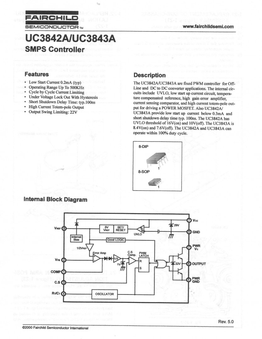

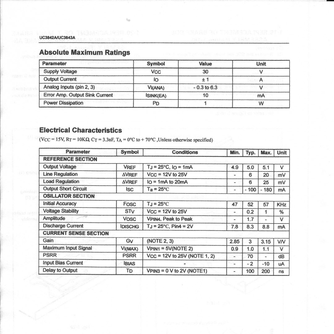

Hi i know its an old post, but was wondering if anyone can tell me either from experience or the circuit diagram what Uc3844 does. I have a blown one (wet foam had fallen on the MOSFET after replacing a thermistor) and there are 2 available on a search of the ic number on element14 that are nearly identical, the only difference one outputs 5v, the other 13.4 v. Can someone tell me which one is right? ( I've ordered both as they are only $2.60 each!) thanks in advance!
DeBe said
06:54 PM Dec 9, 2013
The UC3844 is a Switch Mode Power Supply driver IC. I would be using the original IC number. There is 3 other UC 38xx types which are different. The Mosfet may also be damaged.
bairsjw said
01:47 AM Dec 12, 2013
As mine is blown and the number is no longer viewable I searched using your picture but the number comes up with a couple of possibilities with different following letters ( not on the ic in the picture) the difference being the output voltage, any idea which one I should be using? I have also bought the MOSFET so will replace at the same time.
DeBe said
09:18 AM Dec 12, 2013
The UC3842 is a Switch Mode Power Supply driver IC. I would be using the original IC number. There is 3 other UC 38xx types which are different. The Mosfet may also be damaged. Here is the Data on the UC3842A controller chip, the Ic you are getting should match this, as far as I know there is only one UC3842A IC.
Thanks in advance for any help!
Chris & Marily
au.element14.com/jsp/search/productdetail.jsp
Pretty sure it's right!
This one should be fine as its specs are the same as the A, probably just a later version of the original.
