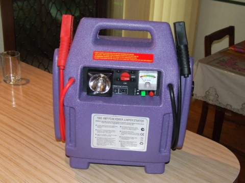

I know..I know.......I have a waeco 40l.....like JRH....I use a jumpstarter a 1900amp/38amphour battery.....starting with 13.85.....in 48 hours it still has 12.8 left...
Sure the waeco isnt a Bushman.....but I beleave everything JRH says.....I've read all the forums.....and statistics and best results are those you get yourself when experimenting.
The jumpstarters are great investment when your free camping when its cold and wet and solar panels arent working...I use mine also to run lights and charge mob phone and camera batterys....and charge them when I'm using solar panel or while travelling
-- Edited by Smokeydk on Sunday 11th of April 2010 07:56:47 PM

Smokeydk said
08:55 AM Apr 13, 2010
I bought my jumpstart from SuperCheap Auto..keep an eye out cause the purple colored ones 1900 amp do sell cheaper at times..
