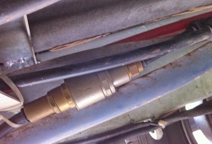

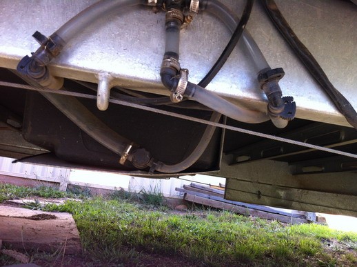

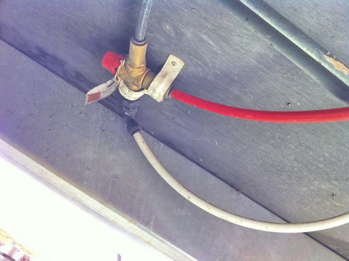

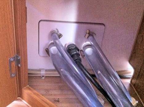

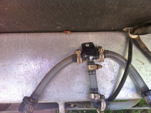

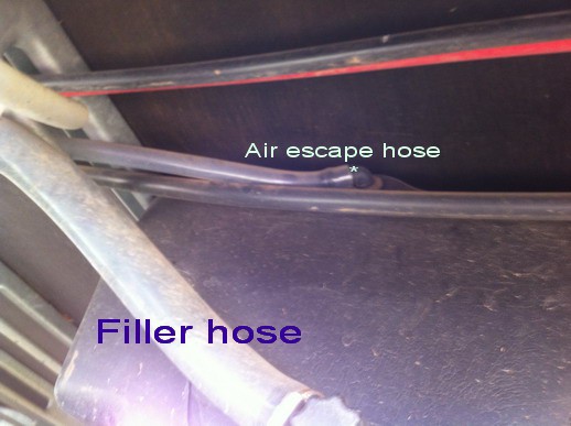

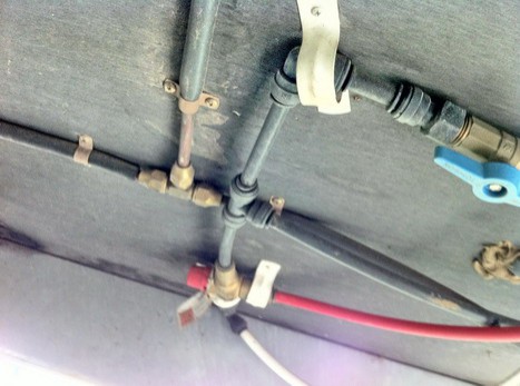

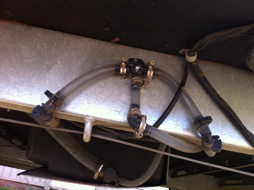

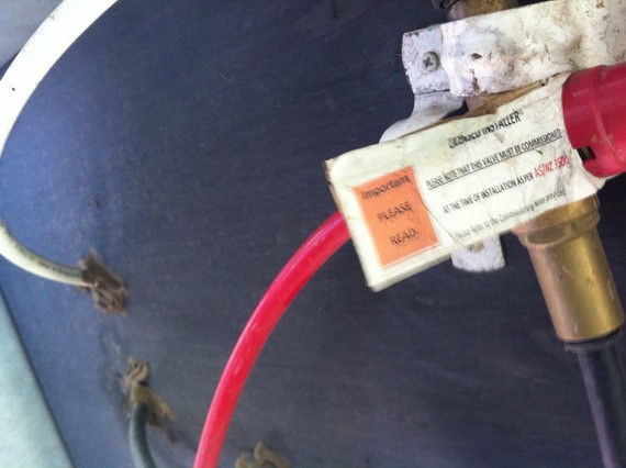

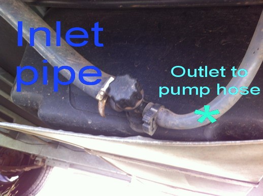

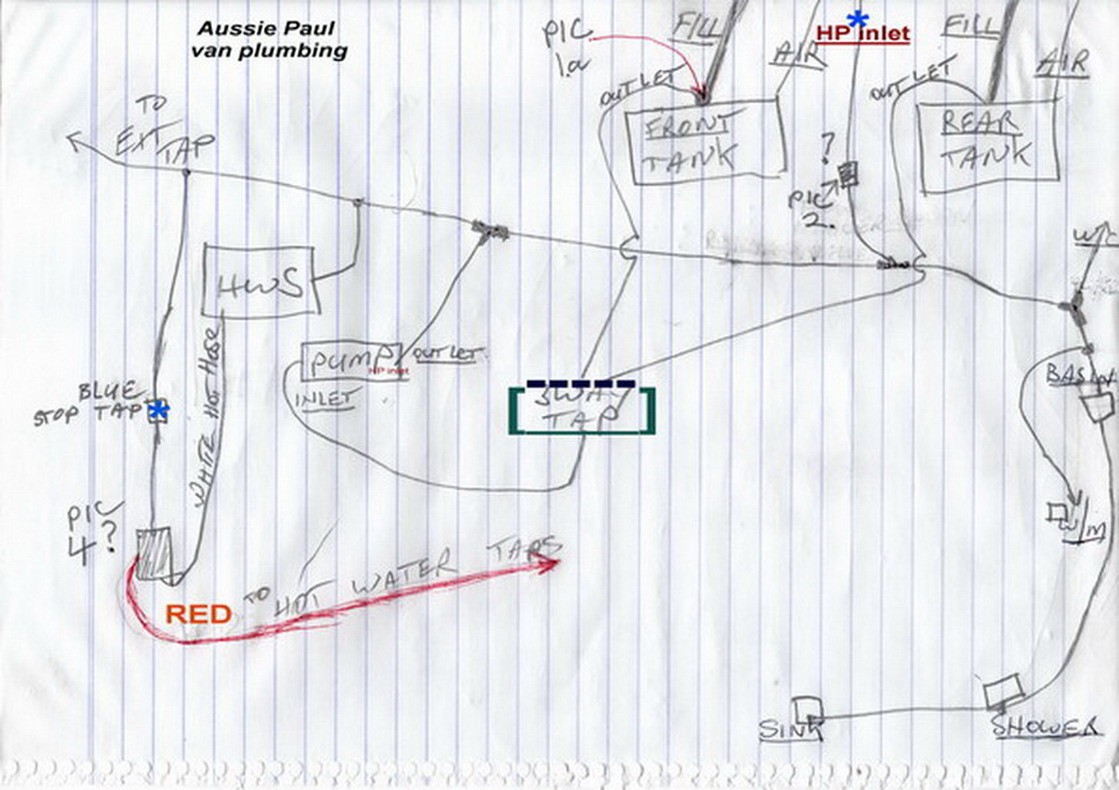

Hi Peter, I have been crawling under the van today to actually see what is there.
I took some pics, but tomorrow I will draw my own plumbing diagram.
Pic 1. This 3 way tap does what you say, either or both tanks can be selected, BUT draws from the same part of the tank the filler goes in. Are you suggesting that I put that 3 way tap down out the tank outlet?
Pic 1. a the bottom of the tank again.
Pic, 2 This pic shows what I think is a one way valve/pressure reducer or possibly both. It is in the high pressure line from external water supply.ie. park water tap.
Pics3 & 4 shows a gadget in the hot water line not far from the HWS.
Pic 5 shows the entrance to the van of the water filler and breather hoses, and the mains supply.
Hi all, I need to know what these two items are in pics 4 & 6. I reckon pic 4 is a non return valve AND possibly pressure reduction. That allows HP water to feed everything. The HP pressure is above what the 12 volt pump cuts in at so pump does not operate, and the pump will have a non return valve inside the pump.. When no HP water connected the non return valve stops water escaping out the HP inlet. Made it easier once I drew it out.

Paul, in the diagram you posted yesterday what you have labelled Pic 4 is a tempering valve. Hot water + cold water in = warm water out. Pic 2 would be the non return valve, whether it is also a pressure limiter or not I know not. Pic 6 in the previous message just looks like the rear of your water inlets plus a cupboard waster.
aussie_paul said
11:12 AM Jan 30, 2015
Hi Peter, thanks. Is that tempering valve used instead of thermostat in the HWS?
Now that I can see how everything works I think I might use the van again and see how it all turns out armed with the knowledge I now have.
After seeing my diagram what would you suggest?
12:27 PM Jan 30, 2015
There is a thermostat in the HWS. Otherwise it would overheat. All storage HWS are supposed to be kept at over 60 deg to suppress bugs like Legionaries disease. If you live in a house over 15 years old you should also have a tempering valve on your storage HWS. Water to bathrooms should not be delivered at over 40 deg or so. Laundries and kitchens can have straight HWS temperatures.
The only thing I can suggest is you can re-plumb the kitchen sink directly from the HWS if you so desire and I myself would not be happy with the pump being the non-return valve in the tank system (personal choice.)

Ah ha Peter, all falling into place now. Many thanks. I appreciate it has been a time consuming thread to help me.
Ok re pump as the non return valve, an easy job that I can do, and I will check if Eril is happy with the sink hot water the way it is. Do most vans have mains pressure reducers?
I should have done the diagram earlier but would have gotten wet laying under the van!!!!
I now know what to do if I drain the tanks. After I refill the tanks I need to attach HP hose to van and bleed the air out.

Now you've reminded me of something. The breather pipes on Sterlings are contorted to say the least. Mine came from the tops of the tanks (normal) and looped down under the chassis and up to the filler box (the white lockable box that contains the fillers and mains inlet) Obviously the breather pipes will get water lying in them and cause negative pressure in the tanks when the pump is working. Not heaps but enough to fight the pump making it harder to draw water. I disconnected mine from the filler box, and using some garden irrigation pipe from the Big Green Shed, ran the breathers back to the rear of the van avoiding any dips that could hold water. At the back I ran them up a short distance behind a box I have sitting on the rear bumper. A minute hole in the breather at floor level prevents any water pooling there, but it isn't enough to allow too much water to spill as I'm driving. Other end plugs will work just as well.
Now the breathers are unobstructed, and the flow from the tanks is easy.

Paul, after seeing your pictures I went on to the CaravansPlus site and found this - http://caravansplus.com.au/images_tiff/2014/800-01574al.jpg - It looks like you have no option to re-plumb the tanks as I previously suggested.

Ok. after some laying around under the van I have a hand drawn cold water plumbing diagram. Does it make sense??
